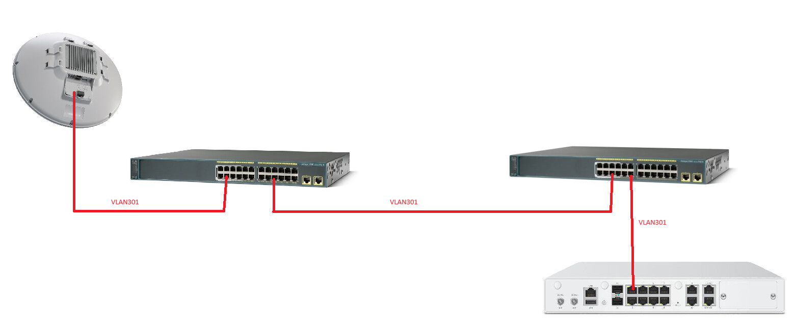

Hi, I have a question regarding bridged mode for the Mikrotik ATL LTE18 but I have a question regarding VLANs when in bridged mode.
I have a second firewall as my primary gateway, this in in a different area on a different switch, on a separate VLAN.
My question is will this setup work when in bridged mode? Will the device in bridged mode work over VLAN?
Thanks.

Yes, just to confirm I mean FULL transparent bridged mode.
I should be fine with the VLAN configuration,
Its more how to setup the transparent bridge
So, something like this,
2 bridge ports,
one with the LTE and the eth1 port with a VLAN tag or vlanx, no ip address?
1 bridge port, with eth1
also with a vlan assigned say vlanxx, and with a IP address.
Switchport setup as a trunk with both vlans allowed on trunk.
Something like that?
