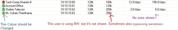

I’ve assign one of the user for 256/256kbps but i’m not able to see his uses from queues list and he is using 512kbps bandwidth i checked it from using torch.

It’s happens not only for a single user. Now i’ve 69 user’s added in my queues. If i add one more user i mean, 70 no. user then i faced this problem. i’m not able to include new users after 69. When i add, new users(after 69 also some user IP like,19, 36, 60 this IP) doesn’t shown any uses in my Mikrotik queues list. also several times new user(after 69 also some user IP like,19, 36, 60 this IP) bypassing my committed Bandwidth.

Thanks for your reply. Here i’m posting my queue rules:
This Client I’m not able to Monitor his BW:
add burst-limit=0/0 burst-threshold=0/0 burst-time=0s/0s direction=both
disabled=no interface=all limit-at=0/0 max-limit=128k/256k name=
Mamun-PC parent=ALL-OTHERS priority=8 queue=
default-small/default-small target-addresses=10.10.10.19/32 total-queue=
default-small
But Bellow Client i can Monitor:
disabled=no interface=all limit-at=0/0 max-limit=128k/178k name=
Oysee-Video parent=ALL-OTHERS priority=8 queue=
default-small/default-small target-addresses=10.10.10.2/32 total-queue=
default-small
Firewalls Rules:
add action=accept chain=forward disabled=no src-address=10.10.10.19
add action=accept chain=forward disabled=no src-address=10.10.10.2
Like This Some users uses i can monitor some are not…

Hi.
The screen grab you have put up only shows us that it’s not working, and we kind of know that from your post.
If I were you, I’d throw a simple queue in right at the bottom that has an unlimited (999M/999M) limit that is a ‘catch all’ on your network(s). This will help you identify one of three issues;
Firstly, if you don’t see any traffic on that when Mr. Suhan is accessing bandwidth, and you don’t see it on Mr. Suhan’s individual queue then you know that a rule further up the chain is catching that IP and giving it a free pass through. I’ve had a quick look at your setup and I can’t see an obvious place where this is happening.
Secondly, if you DO see traffic on the catch all (assuming that ALL other users in that network are all queued appropriately) that when Mr. Suhan is accessing bandwidth then Mr. Suhan and his IP don’t match up. I.e. you have one ip in the queue and a different one on the NIC.
Thirdly, assuming you don’t want anyone accessing your bandwidth without being queued it’ll give you a warning that someone is accessing your bandwidth freely. (An alternative is to set this ‘catch all’ queue to 1k/1k limit and that way it’ll stop people getting access to your bandwidth UNLESS they are in a queue above).

Not Solved. Tried your instruction.
Can you please explain what happened when you tried my suggestion, simply saying it did not work is insufficient to allow me to help.

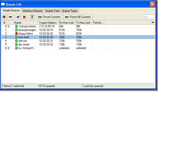

hello,
i have a similar problem, where i shaped some ip on the network but it seems they are not working well.
I want to find out, how do i block other ip addresses in the network that are not being shaped not to access the internet, cus there is one user who is always changing his assigned ip address to another one that is free, so that he can browse unshaped.
As you can see, there are other ips that are not shaped, how do i restrict them from accessing the internet.
See the screenshot below
