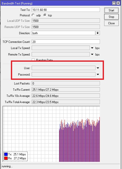

In the Tools open BTest Server and check Enabled
tool bandwidth-server set enabled=yes
Now you can do Bandwidth test (if you can ping remote address).
See that Authenticate is not needed (red square) and if you want authentication you can check box in previous window (see post above).
