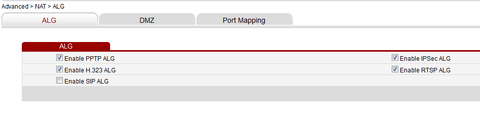

Here are the avaible NAT options on my huawei hg253s. Currently they are enabled as I reverted back to the settings.
I think you are looking in the wrong place on your modem. You want to turn it into a bridge instead of a router. Most modems I’ve seen, you just disable NAT and this happens. The screen shot you show looks like something else.
