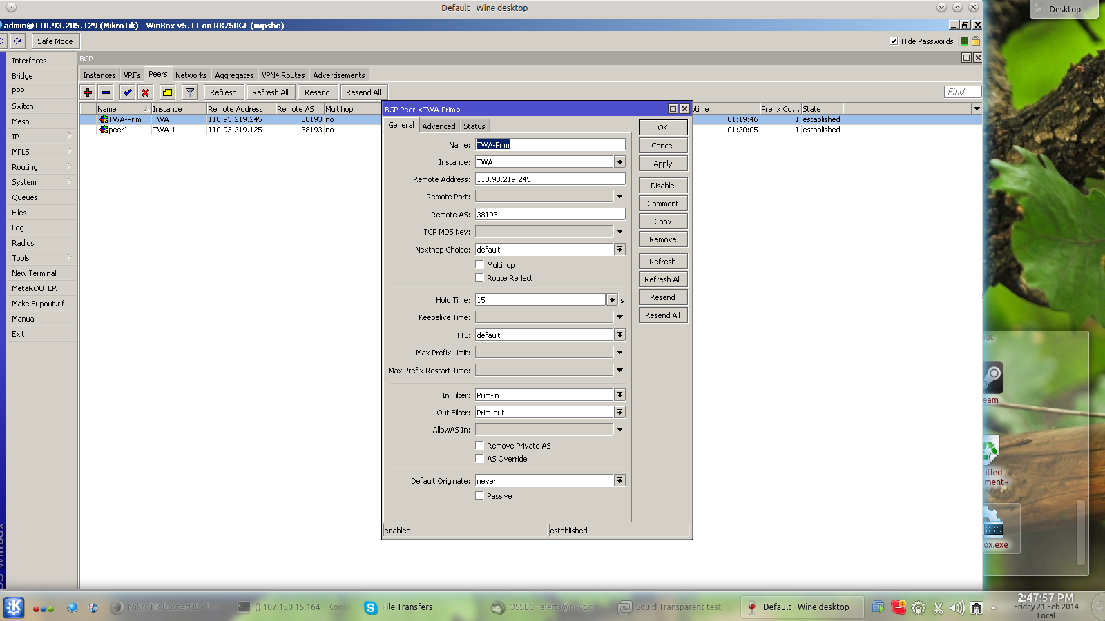

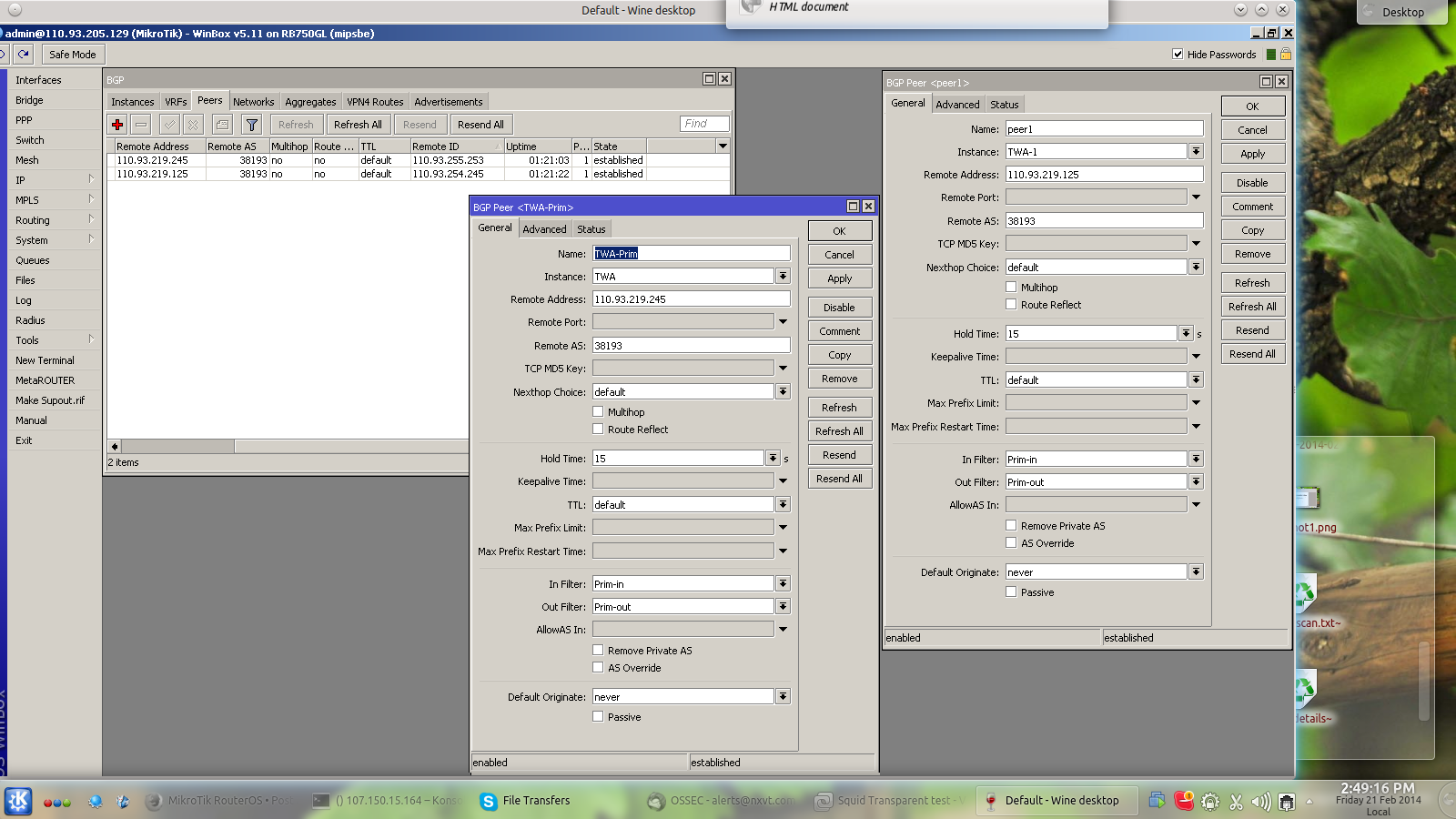

HI,
I have an issue with mikrotik Rb-750 gigabyte, 5.11 v router board BGP configuration. My router using my both ISP connection for download and upload bandwidth while i monitor in interface but i want to use my 1st connection as primary cnnection and secondary mean 2nd isp connection as backup connection how can i prioritize my primary connection for upload/download traffic in my router and keep my 2nd ISP connection as backup.
You should:
  1. Use DIFFERENT in- and out-filters for the peer1 and peer2
  2. Add a rule in peer2 in-filter lowering local-preference (for example - to 50)
  3. Add a rule in peer2 out-filter setting bgp-prepending (or, if the AS doesn’t accept the prepending, a special community that is accepted by the operator)
    (edit: ach, now I see that the peers belong to the same AS… Then you can try setting a MED in out-filter for peer2)
