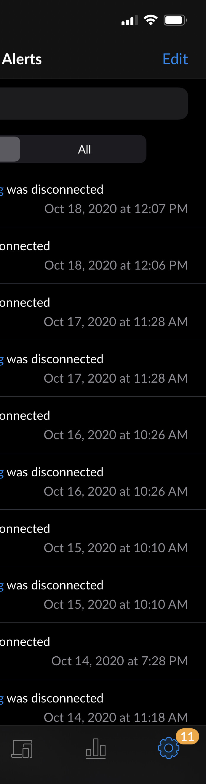

So for some reason the Mikrotik Router seems to randomly be blocking remote access to some port forwarded devices. It’ll work just fine for days on end sometimes then abruptly drop any incoming connections.
This happens both with;
  1. Camera system with remote web / remote app ability
  2. Unifi Access Points stop communicating with the off-site controller and show as offline (But there is no firewall configuration that needs to be done on the remote site where the Mikrotik is, so not sure how this relates but this also happens while the camera system goes offline)
    The network works completely normally on the LAN side, when I go on site I can get on the internet with everything just fine, use wireless access etc…

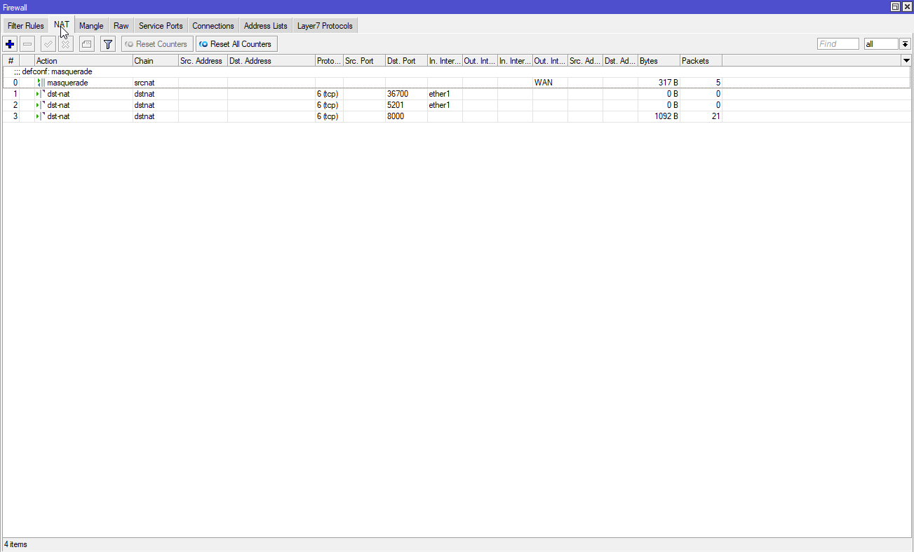

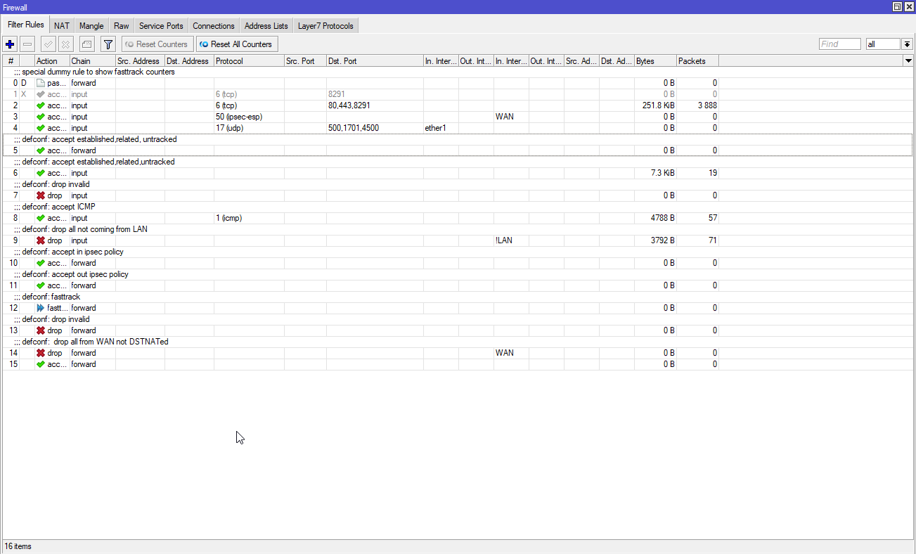

How I have it setup;
Firewall > NAT I have a DST_NAT action with donate for the chain, the destination address is the WAN IP, protocol TCP Destination Port is the port to be forwarded
I’ve checked both
https://www.balticnetworkstraining.com/mikrotik-port-forwarding/
and
Port mapping/forwarding
If you would like to direct requests for a certain port to an internal machine (sometimes called opening a port, port mapping), you can do it like this:
/ip firewall nat add chain=dstnat dst-port=1234 action=dst-nat protocol=tcp to-address=192.168.1.1 to-port=1234
https://wiki.mikrotik.com/wiki/Manual:IP/Firewall/NAT#Port_mapping.2Fforwarding
Neither variant seems to resolve it, rebooting the router doesn’t change anything.
Abruptly all of the sudden it’ll eventually start working again…
What gives? What else can I provide to help you guys diagnose it
I can remotely access the router with zero issue with the configuration I have so I know that works.
So once again out of nowhere at around the same time after no matter how many modifications I made with no success… it randomly started allowing traffic again at night, then this morning at roughly the same time it started blocking it again
This is freaking infuriating

(1) I find it confusing you have the bridge handing out DHCP and you have ethernet 2 part of the bridge, but look at your ip address!!!,
add address=10.192.0.1/24 comment=defconf interface=ether2 network=10.192.0.0
I would guess that that should be bridge not ether2
add address=10.192.0.1/24 comment=defconf interface=bridge network=10.192.0.0
(2) As far as firewall rules go you have some weird ones in the input chain…
However I am not an expert on VPN so I will assume they are fine.
For clarity sake I would put all the input chain rules first and then display the forward chain rules.

Just an update with no changes on my part the camera system and access points are back online in unifi controller
I suspect once again tomorrow around the same time they’ll be off again, but not at the exact time just roughy and with no interruption to LAN traffic (cameras still record and WiFi clients can still connect to the internet)
But remote connectivity blocked, other than winbox / direct access to the router via web those work
As you can see it continues to go offline at roughly the same time every day
