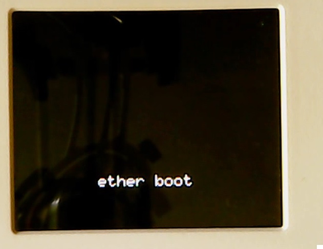

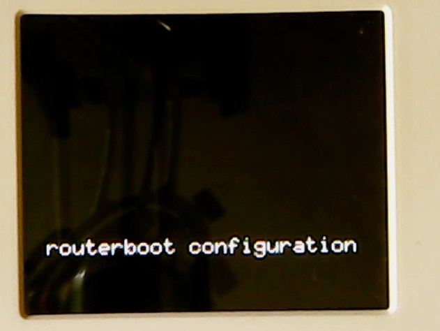

My Mikrotik:CRS125 stopped working… after 4 years.
I cant get the access via console cable. He showed a few random charts only… video record - https://youtu.be/_qx8XHFT03k .
I would like to ask you if is possible to flash the new firmware in this case. If yes how can i make it?
I am looking forward to you reply
If the message “ether boot” means that it’s trying to boot from network (I don’t know, just a guess), then you can try netinstall:
https://wiki.mikrotik.com/wiki/Manual:Netinstall
