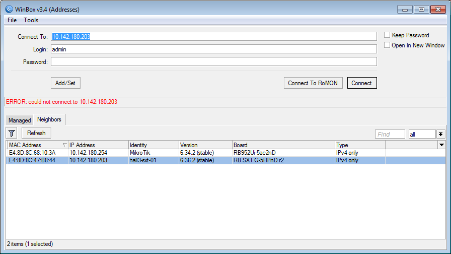

I just put bridge1 as “in interface” and after reboot I can not connect to device with winbox anymore!
Your WAN interface is not Bridge1 but one of the Ether interfaces. That should be there. I don’t know if you have changed the basic config any further. So try.
What you can do, but is poses a risk, is to disable the firewall for a moment and activate one rule at the time until the “error” occurs Then you have a point to work from.
Just put “all ethernet” in “in interface”, and it is looks OK now! Can login with winbox after a reboot!
