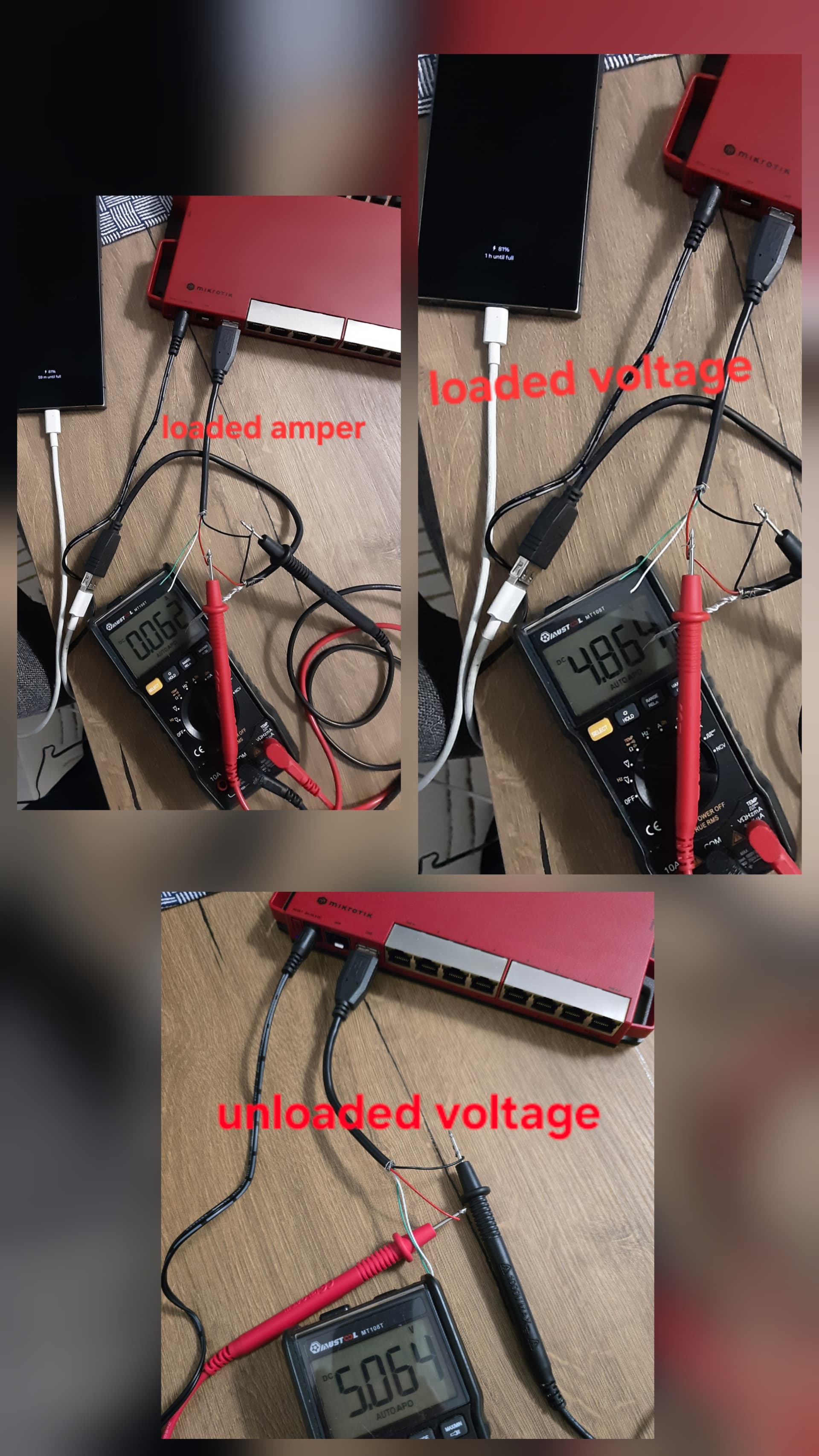

Here is the multimeter measurements:
Unloaded voltage: 5.064
Loaded voltage: 4.864
Loaded amper: 0.062
So, voltage is perfectly in line with standard 5V. (typical is +/-5%, so 4.75-5.25V)

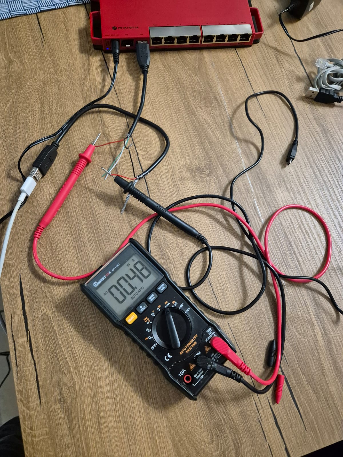

Allow me to doubt that you are actually measuring Amperes with probes connected in parallel to + and -, though (they should be in series with the load).
A charging phone @5V should normally use between 0.5 and 1 A, anyway, even if trickle charging, something in the tenths of A, not in the hundredths.
It's resuidal current that flows via multimeter that should have megaOhm resistance for voltage measurement and very low one for current measurements to not "steal" too many volts/ampers from the source.
You are right. I am not professional. My mistake.
I connected in series. That time i got 00.48
But the phone wasnot seeming charging.
I am unsure whether i measure correctly.

no, there is still something that is "off", with the tester set to mA, you are measuring 0.48 mA, i.e. 0.00048 A, please read as "nothing", no surprise that the phone battery is not charging.

Sure, the important test was the voltage one (verifying that there was not a short of some kind or other board circuit failure that gave out 12, 24 or 48V on the USB) once checked that the port is at 5 V, the actual amperage drawn from it depends on the device attached to it, hopefully your new USB stick will draw something like 20-80 mA at idle and 200-400 mA (maybe 500) when performing read/write operations.

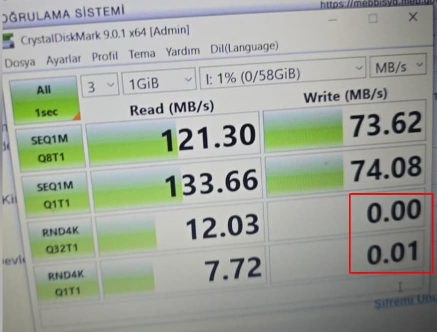

All that being said, what actual tests did you do on the PC? a 1 second crystal mark test isn't going to be very useful.
If the results you posted were for the KIOXIA, it appears to have poor random write performance, but that's not uncommon for flash drives. Did you run h2testw or GRC's validrive? I would have expected validrive to be slow given the results you saw, because what validrive does; small reads and writes without any queuing is similar to the Q1T1 results are based on.
