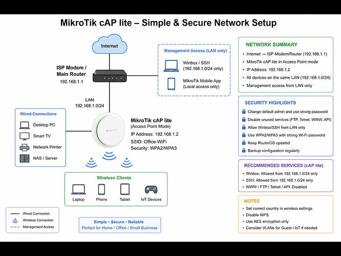

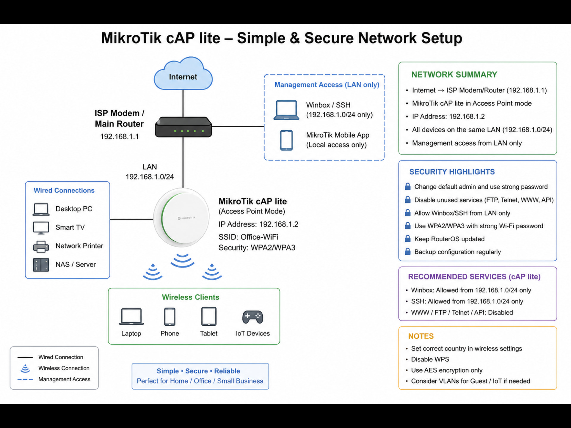

Created a prompt and this was the result, pretty much covers what I need to setup this as a simple AP for iot 2,4Ghz devices.
Hi, prompt more.
Please do not post these AI generated "manuals".
The first one shows that you need AI to properly formulate your own needs.
The second is a wishlist, not even the checklist for newbies as it does not say how to do these things and some "advices" are not correlated to others.

No need for flooding the forum with unchecked "something" that pretends to be help for others. You can find a lot of topics on this forum covering the problem you have. Just do search.
My advice is to write these "cheatsheets" by yourself as preparing such a document forces you to double check the real effects before releasing (I hope as I'm a little old schooled) for others.
Do not expect commenting that AI generated bull.....t.

The Ai prompts are generally nice to look at, but found then to be inacurate, especially with wiring schematic, which makes it extremely dangerous, especially when working on 1500 amp circuit breaker @400V. Thanks for pointing out the issues, I was hoping someonewould guide me in the right direction.
