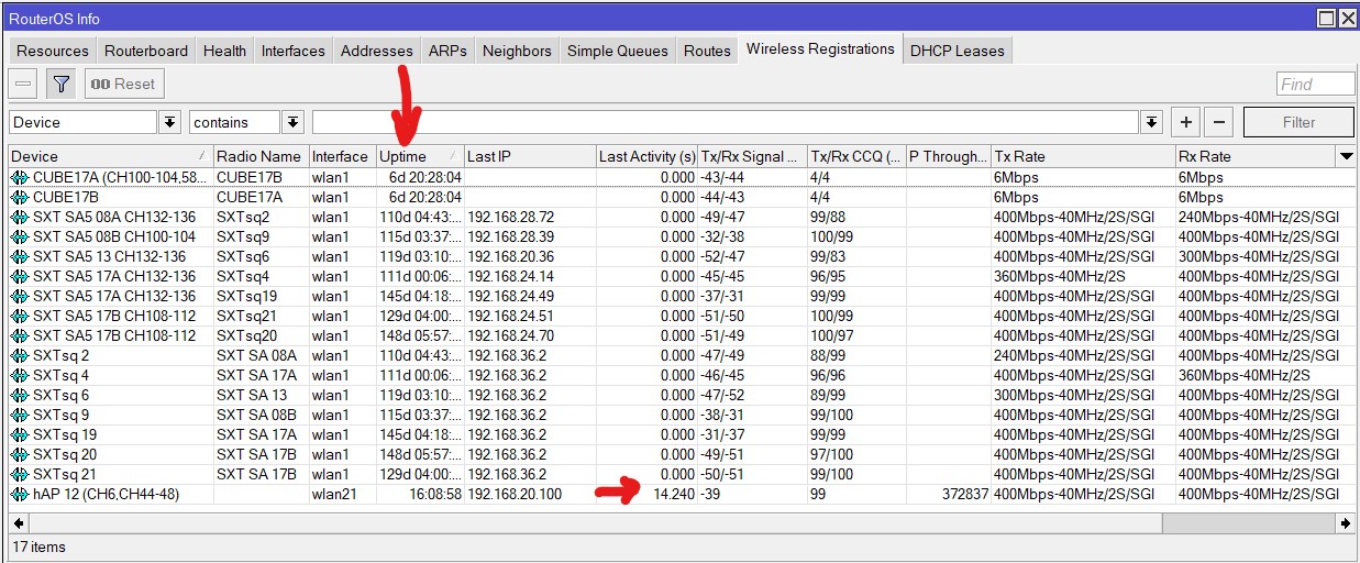

Mikrotik can be stable. Certainly in PtP and PtMP. But also with client devices, even a sleeping MacBook that only checks wifi every 20 seconds.
CUBE17A building had a power failure. The connection in 5 GHz is only failover. Values for CCQ and interface rate only rise when used.
Powerfailure is the trigger for disconnects, since Engenius and Draytek have been replaced with Mikrotik.
CAPsMAN is not used, as I don’t like SPOF’s in the network. DUDE collects enough information.
