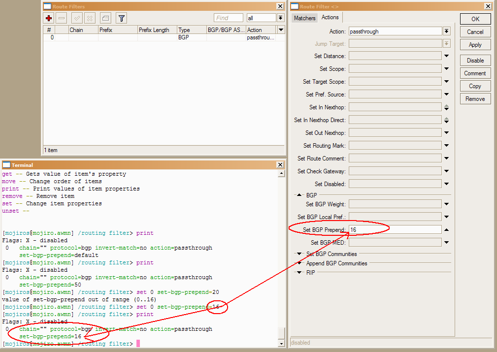

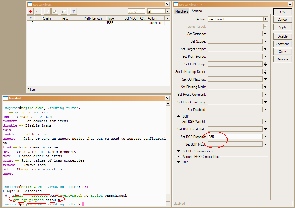

from Winbox, we are allowed to set prepend up to 2^32… and 255 seems to be the default value

When you are editing prepend from console, you are allowed to set it 1…16
When you are editing prepend from winbox, you are allowed to set it 1…2^32
1st mistake, we are allowed to set it up to 2^32
2nd mistake, 255 seems to be the default value, should be 0 or null (=> not set => not used)
3rd mistake, routing daemon accepts these values even they are strange

Ouch, what a crap! I just defended Mikrotik on the Nanog mailing list a few days ago when this was a hot topic, stating that this must have been fixed in recent ROS versions as the CLI didn’t allow me to enter anything else than 1-16.
I presume this will be fixed ASAP in winbox as well.
