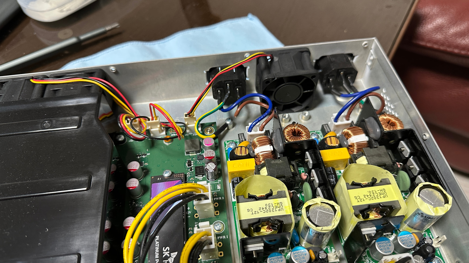

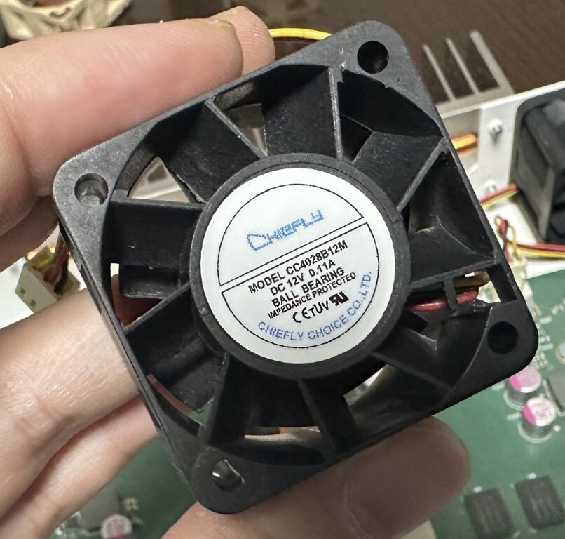

I have a spare original MikroTik Chiefly CC4028B12M fan that I removed from my old CCR1032.

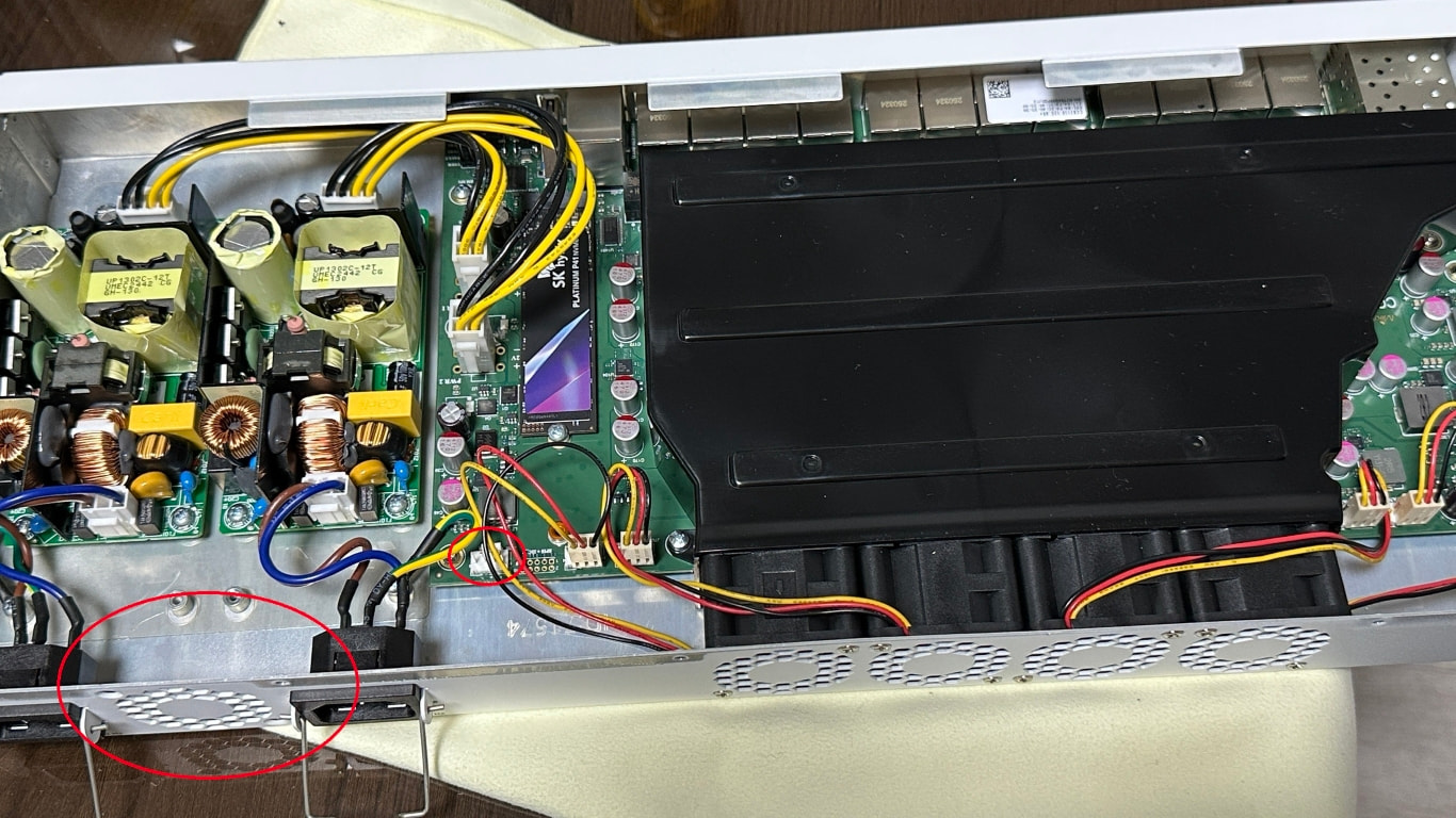

I am currently using a CCR2116, and I’m considering installing this fan as a fifth fan in the CCR2116.

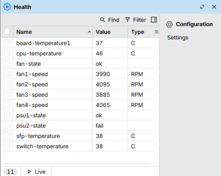

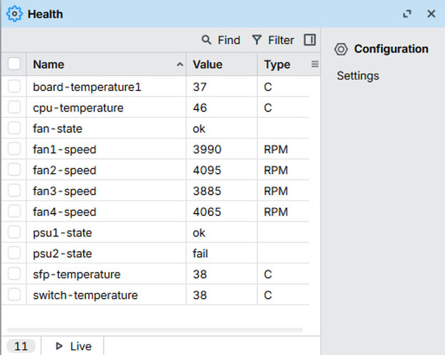

From what I understand, the fifth fan is not detected or shown in /system/health on the CCR2116.

Well, clearly (see also this more complete picture of the inside of a CCR2116:
https://www.discomp.cz/mikrotik-cloud-core-router-ccr2116-12g-4s-big_ies4123747.jpg
The only function of such an additional fan in that position would be that of cooling the power supplies, it will have NO effect whatever in cooling the "little stoves" (please read as "SFP/SFP+ modules") or the CPU and other chips.
The CC4028B12M should be a 3 wire 12 V fan.
So, get a (completely independent) fan controller like (example only):
https://www.aliexpress.com/item/1005010785087710.html
and use it to keep the PSU's cool.
Thank you, I just completed it and fortunately the noise is not that loud. Of course, it does not appear in the system/health. I am satisfied.
