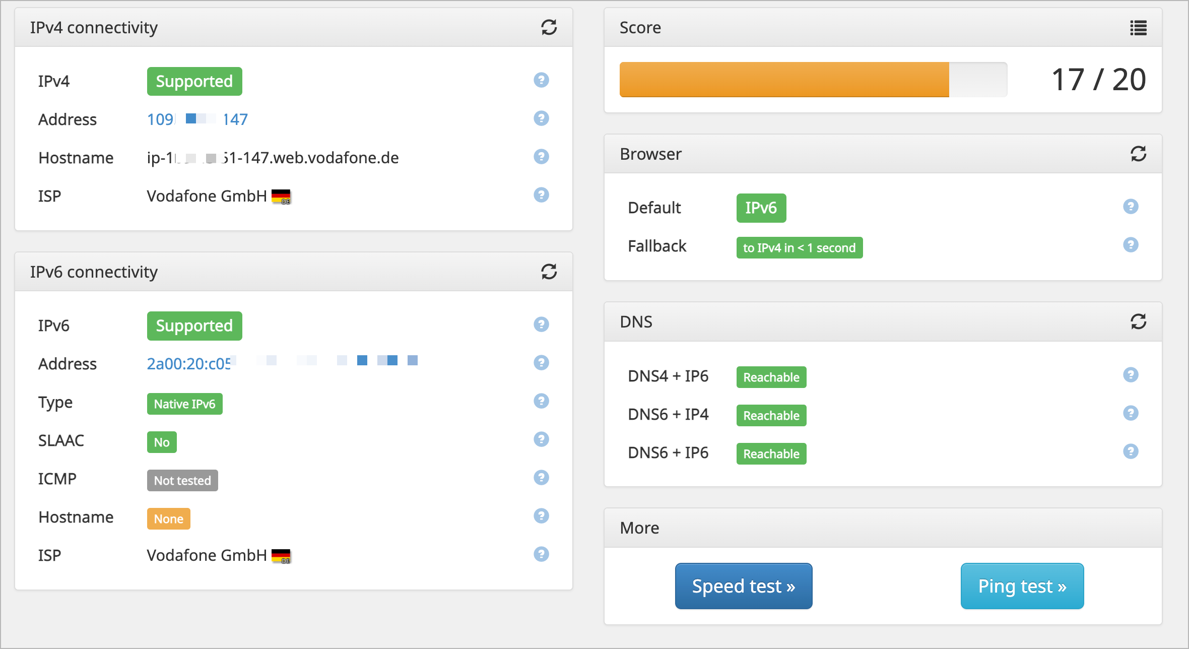

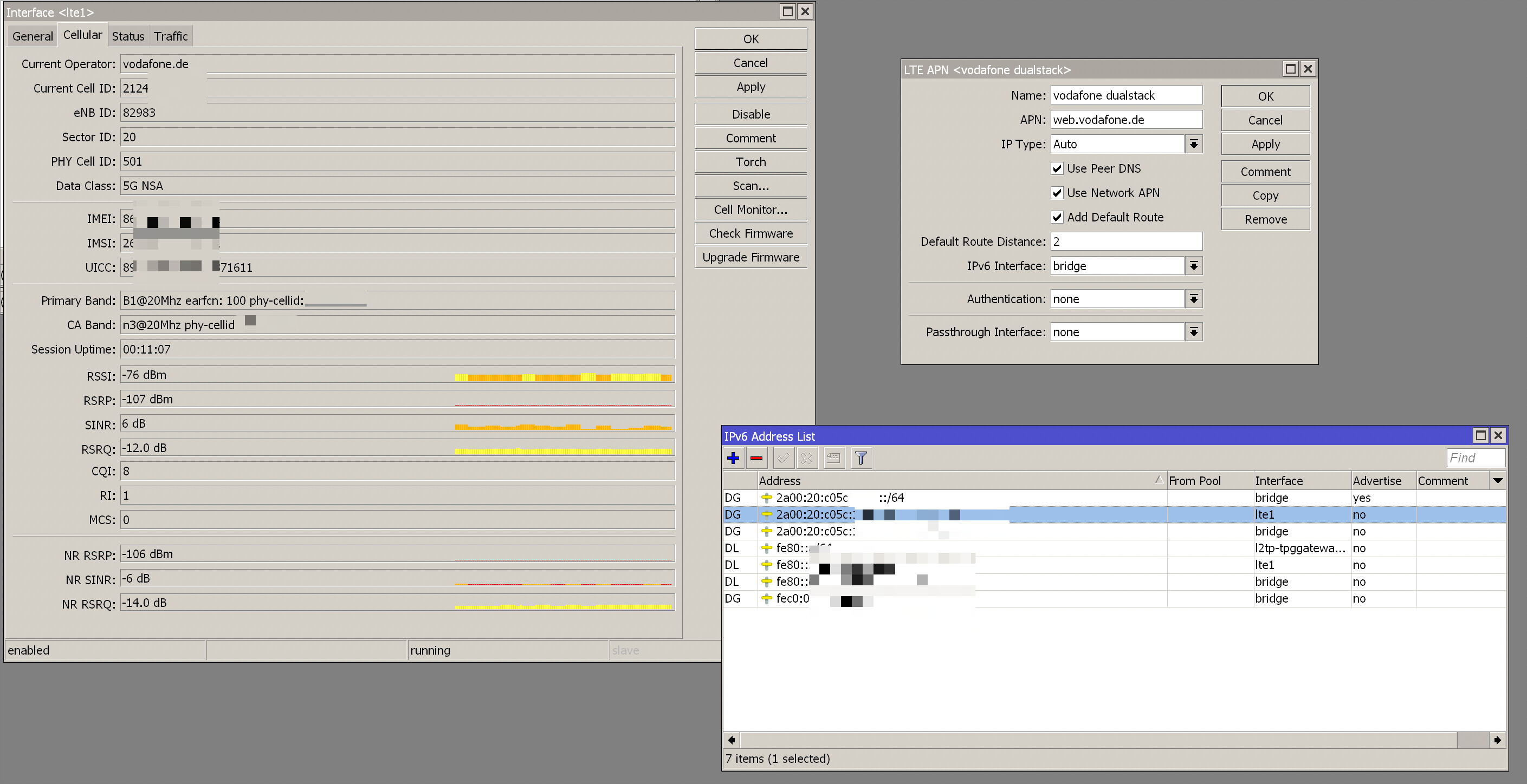

Just right after my post I checked the IP on my MacBook and I have IPv6.
IPv6/ND is set to bridge interface (ether1..5 and wlan interfaces).
Currently using Vodafone over 5G, will check with Telekom soon.
