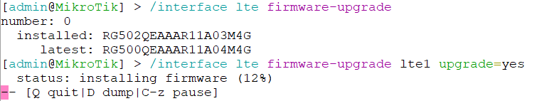

The firmware upgrade command is now working on my Chateau 5G, at least for me:

I think they uploaded the wrong version. The chateau 5g module is rg502q-ea, the update firmware listed in your screenshot is for the rg500q-ea that is another module. I think this is the wrong firmware
That’s annoying - I did not notice that. From checking what it installed, it appears to have installed the RG502… however, it certainly is behaving different to the previous version.

I used the built-in firmware update commands as shown in the screenshot in post 12. Unfortunately, it was only after Salvot2990 mentioned that I noticed the wrong model # in the firmware version.
Hopefully whenever MikroTik puts correct firmware up that it will let me do an upgrade, especially with it reporting the installed firmware as RG502QEAAAR11A04M4G, unless the hosted firmware is correct but with the wrong title.
There was just typo in the firmware upgrade name - the firmware is correct.
