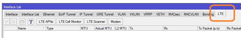

Did you find the LTE interface tab I displayed?
Did you try and select LTE APN and insert the information provided by the provider ( or perhaps the MODEM ) not sure the entry point for adding an ISP ???
Yes, as mentioned before, LTE / lte1 is up and running:
Sorry I didnt see where you said it was up and running. Thus you do have an interface right.
Does it not show up on the interface tab ?
Does it show up anywhere for selection on any rules?? ie the name LTE1 ???
Yes, it does show up:
