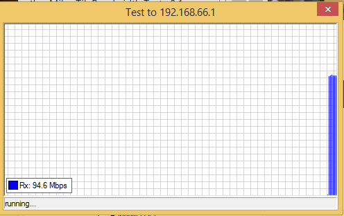

I just bought a new MikroTik Cloud Core Router 1036-12G-4S and just set-it up for working in my office.And right before removing my old router i test it with the tool that is from mikrotik Btest
and i fund out that the router with VLan setup max speed of revive or send is 94 Mbps and i am asking how to fix this speed coz it’s to slow for our needs.

I had a similar experience with my 750Gr3 when I got it. Turned out the interface was set to 100 Mbit and the cable was at fault. Switched cabled and I can now handle almost 1 Gbit. :slight_smile:
