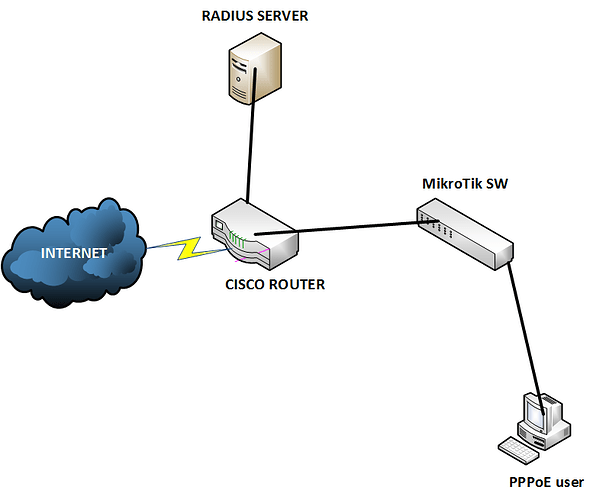

Dear Users,
The basic scenario:
a. user to use pppoe protocol to internet
b. cisco router: pppoe server, dhcp server and main bandwidth manager
c. radisu server: the user account and user bandwidth template
  1. The user would like to connct the internet. The user start pppoe request: Who is a PPPoE server?
  2. Cisco answer and ask: I am the PPPoE server. Do you have username and password?
  3. The user send the your username and password.
  4. Cisco get the username and password from user and it send request to Radius Server: Are these username and password valid?
  5. Radius answer to Cisco and send bandwidth template to Cisco: Yes, these datas are valid and I send the user bandwidh template.
  6. Then Cisco gives IP address for the user, It provides the way for the user to internet and It controls the bandwidth.
    But I would like to configure bandwidth control on the MikroTik CRS switch ports, too. I would like to use different bandwidth limit on the different ports. This is the config:

Ether1 is trunk port. Ether2 and vlan1610 is in the bridge1610, this ports are in same lan. I would like to use the bandwidth limit on ether2.
Please help me in the bandwidth control setting.
