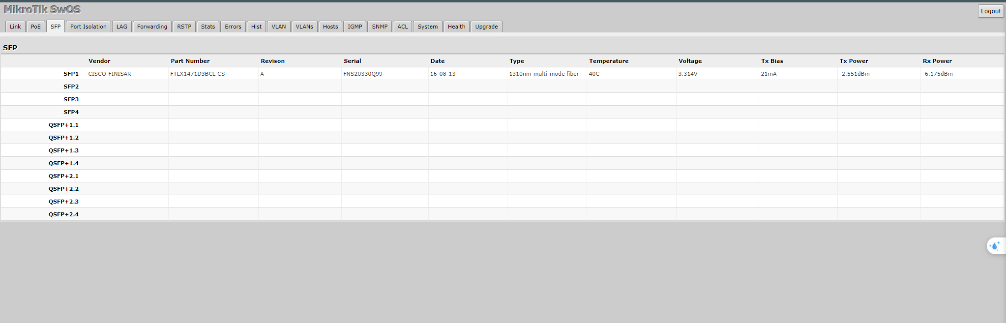

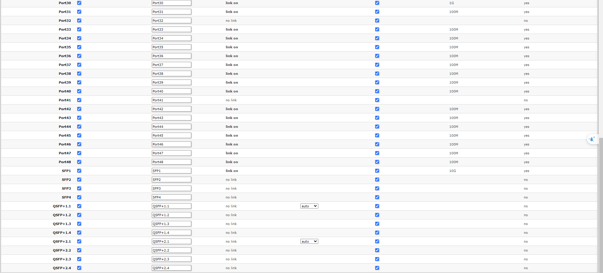

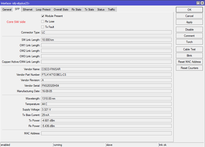

We have a network setup comprising 20 Mikrotik switches, all of them running on SWoS except Core one . one of the switches, running SWoS version 2.13, has encountered an intermittent problem with its SFP port. This specific SFP port periodically ceases to transmit and receive packets, resulting in a loss of connectivity. The issue occurs sporadically, with the port functioning correctly for variable durations ranging from 2 hours to as long as 14 hours before the problem resurfaces.

Attempted to disable and re-enable the affected port on both ends but without success.

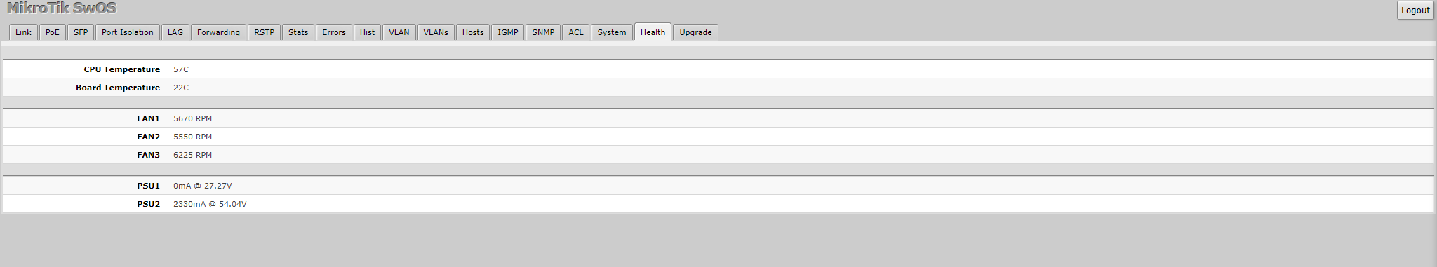

Monitored RX and TX power, which showed activity despite no packet transmission during the issue. The SFP port indicator continues blinking during the downtime.

SFP module in use: [Cisco ( Please refer to the attached)
