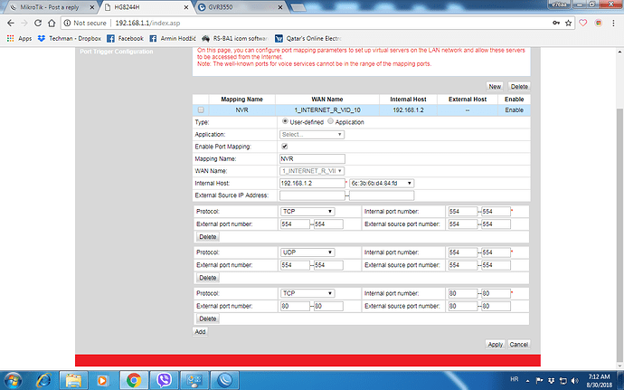

On the gateway 192.168.1.1, it's open port mapping to 192.168.1.2 (Mikrotik)
, then on Mikrotik firewall :
