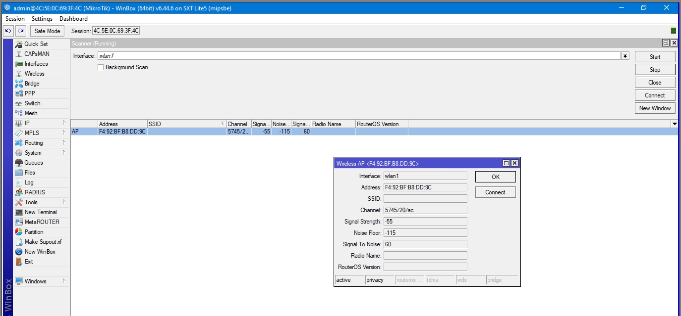

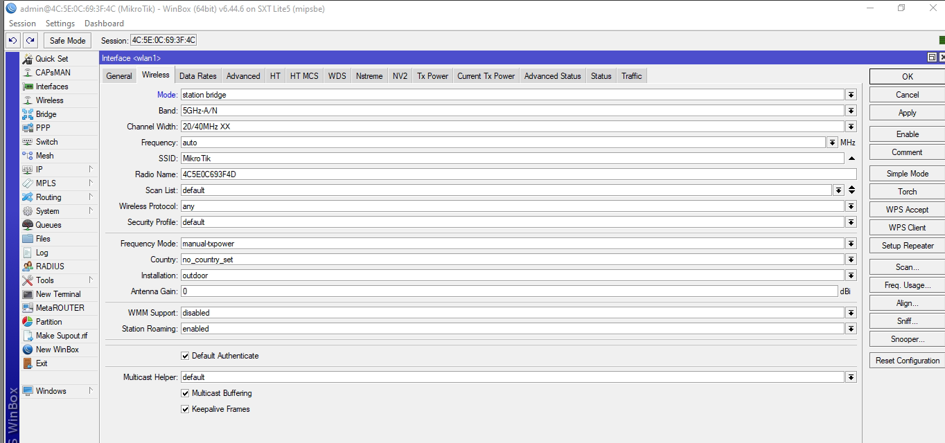

I have Ubiquiti LiteAP AC LAP-120 and Mikrotik RBSXT-5nDr2 SXT Lite 5 devices.
Lap-120 device is set as transmitter and Mikrotik device is receiver.
Lap-120 internet appears anonymously on Mikrotik and no connection is made.

The ubiquiti LiteAp ac is not compatible with any of the Mikrotik products, it will only link to Ubiquiti products.
