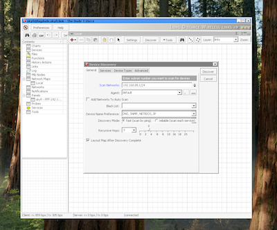

FWIW, Dude client still works on latest MacOS Sequoia + homebrew’s wine@devel. Since the client will re-download itself for another version, that even work still (since I connected to v7.16rc4 Dude).
