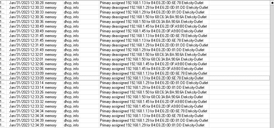

I have a network with 30 devices I am using a mikrotik router that is configured as a DHCP server for all attached devices.
Lease time is 5 days
I have 3 smart outlets that refuse to connect unless the Mikrotik is rebooted daily they connect fine after a reboot.
I also have a smart TV that with the mikrotik says there is no internet on the wired connection, however it connects and works fine using a wireless connection on the mikrotik
If I unhook the Mikrotik, and hook up a netgear router everything works and connects with no issue and remains fully functional for months at least, probably for years.
Hooking up the Mikrotik the 3 outlets and the TV fail to connect.
I really want to like and use the Mikrotik because I can use some of it’s other features but this failure to connect issue makes it a non starter.
I have upgraded the firmware no change, I am attaching a log file so you can see what it starts doing after a few hours or a day or so.
If you set the lease time to 1 second, that’s normal…
From your screenshot it looks more like 5 SECONDS.
Show the config !
BTW …is that a recent screenshot ? Your time settings on that router are possibly completely wrong (I don’t even need to know in which time zone you are, Jan 31st is already LOONG gone).
Not the first time I see DHCP issues due to completely wrong time settings on a router.
Check that one too please.
