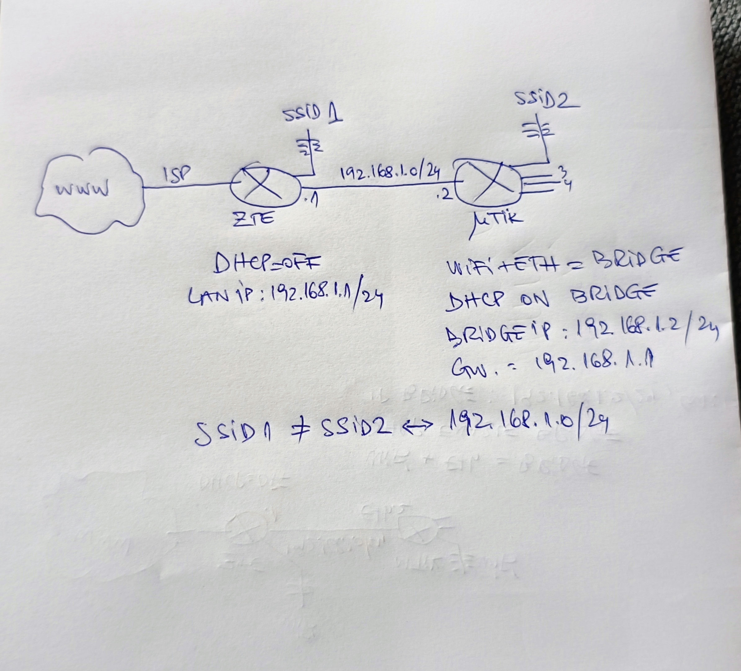

I have a basic home setup, picture bellow: ZTE F618 from ISP with 1 LAN port and hAP AX Lite connected on Eth 2.
ZTE and MT have different SSIDs and share the same LAN subnet 192.168.1.0/24 (i need both SSIDs). At this moment, dhcp pool from ZTE is 192.168.1.20-120 and pool from MT is 192.168.1.135-240, and MT has a default route to ZTE.
Everything works ok (openvpn, wireguard, connectivity between devices, dns …) and my goal is to use only one dhcp server, the one from MT (for better management purposes), but when i turn off ZTE’s dhcp, registered devices to ZTE don’t receive ip addresses from MT.
I think is something related to the ARP/bridge/broadcast, but i don’t know what and here i need your advice.
My last attempt was with proxy-arp on the bridge, like in config bellow but got no luck. I’ve tried also with LAN ip address 192.168.1.2 set on the interface, not the bridge.
I don’t see dropped packets on firewall logs regarding udp ports 67-68 and all rules with action=drop have log enabled.

If my network setup is wrong for what i want to achieve (to use only Mikrotik dhcp server for both SSIDs), please let me know what is the best solution.

When clients are connected to the ZTE device on SSID1 can they ping your Mikrotik address 192.168.1.2? This would show at least layer 3 connectivity works.
Pool bridge range is from .135 to .240, so 106 addresses available :wink: . I have around 50 clients, so no issues here.
Yes, there is connectivity from ZTE clients to MT clients.
I’m thinking the ZTE don’t broadcast the dhcp discovery packets on LAN port, but i’m not sure about that.

Tried that with all interfaces and no packets matched the capture filter.
There is no dhcp relay option on ZTE.
Regarding L2 connectivity between devices, i see mac addresses from one device to the other, just the broadcast from ZTE is filtered somehow/somewhere.
