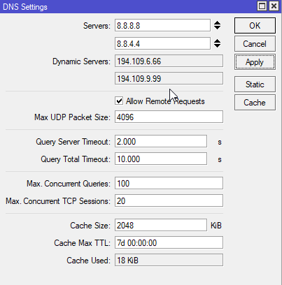

I have a CCR1009-7G-1C-1S+ with firmware 6.42.6
I have a working internet connection when the client have a fixed IP and DNS settings. When the DHCP server in the router serves IP addresses and a public DNS address like 8.8.8.8 is it aso working.
When i try to use the internal DNS server it is not working. Set on the client by fixed settings and DHCP.
I have set the “allow remote requests” tick box. See the other settings in the pcture.
I have also tryed some firewall settings without luck
What do i miss???

Thanks for the warning; To my knolage this ia aleady taken care by the fire wall. GRC shieldup is showing port 53 as closed.
Problem is solved
After more testing i found that the firewall was blocking the DNS request from the network. I have added a firewall rule to make it possible
