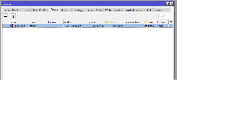

But I see I have RX traffic but no TX traffic.
See the picture.
Is that the problem???

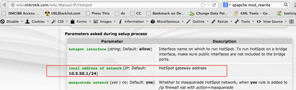

I’m surprised that specifying the size of your subnet on hotspot gateway address is giving you an error. Having a hotspot gateway address that is a /32 wouldn’t work which is what I am concerned that might be happeing. I am not sure that I am reading the config correctly. I have not configured many hotspots so I’ll have to build your config or as close as I can on a machine here in order to be sure. I won’t however have time to get to that for a few days. I hope you can figure things out before that however if you cannot I will be willing to help.
http://wiki.mikrotik.com/wiki/Manual:IP/Hotspot
