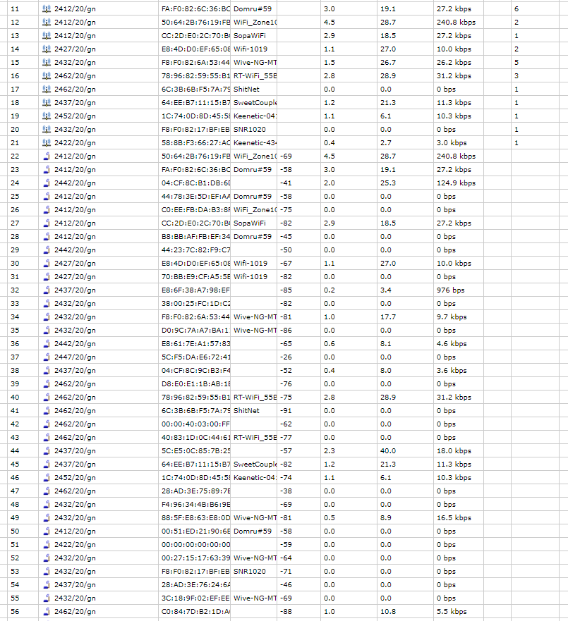

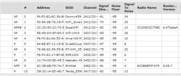

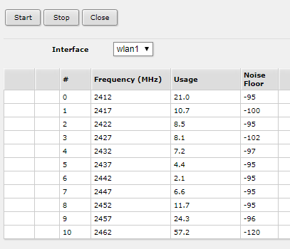

That’s what I got. Is it too crowded?

Well this is far from overcrowded, but it is one big mess. Those devices could all work nicely together, and share the available wifi spectrum with good performance.
Due to the disturbing “auto” implementations, and maybe some ignorance of the device owner, you have full destructive adjacent channel interference in the environment, instead of collaborating co-channel interference.
The AP’s are not that bad, but other devices are just as destructive.
You should only have 2412,2437 and 2462 as center frequency for 20 Mhz bandwidth (non interfering channels 1, 6 and 11). Zillion of documents and youtubes to be found on this topic.
There are some AP’s which do not comply, but they are weaker than -86 dB
However the client device at 2447 with -27 dB is a killer!

  2. Weed out this 2.4 GHz environment. What is yours in this list? (It could be much more than you think, the line 37 2447/26dB device is normally very close to the RB2011, or it must be unbelievable strong (dangerous and illegal). All devices with a signal lower than -86 dBm can be somewhat ignored. There might be enough room around 2437MHz . In that case the 2412 and 2462 do not interfere and can be fully ignored. Do not rely on “auto” frequency selection, pick it manually ! Almost always the case !
Line 37 5C:F5:DA = Apple Inc
