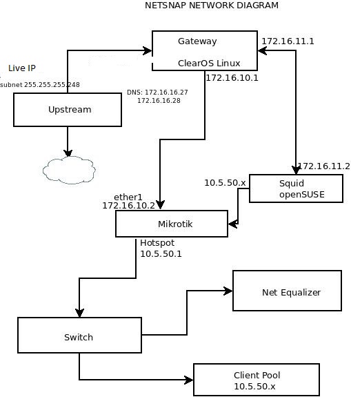

Good morning,
I have been trying unsuccessfully for a while now to introduce a
transparent squid proxy onto my network. If I leave it as a non-transparent proxy
everything goes well excepting that I would have to go around all the
clients and input the proxy details. Also I discovered that I don’t really
know enough of Linux to dabble into the IPTables area to open the required
ports; eg port 25 for smtp then 110 for pop etc.
Now on transparent with the various CLI commands I see online I don’t get
to push the required http traffic thru from the MikroTik to the squid like it does when running on non-transparent. Also there is a mistake in the diagram, the IP of
the eth2 of squid is 192.168.50.1 the the IP of the corresponding eth on
the MikroTik is 192.168.50.2 and not 10.5.50.x series as shown in the
diagram.
Attached are the following, the network topography, the squid conf file &
the Mikrotik output file.
I just tried this morning to with a RB1100 to set it up and i used the below CLI commands and i will paste the error message i got while running the tail command on the squid box! the CLI commands are as follows:
add action=accept chain=srcnat disabled=no dst-port=80 protocol=tcp
/ip firewall mangle
add action=mark-routing chain=prerouting disabled=no dst-port=80 new-routing-mark=http passthrough=yes protocol=tcp
add disabled=no distance=1 dst-address=0.0.0.0/0 gateway=(192.168.50.1) routing-mark=http scope=30 target-scope=10
add disabled=no distance=1 dst-address=0.0.0.0/0 gateway=(172.16.10.1) scope=30 target-scope=10
When i try to browse from any Pc on the network it doesn’t open pages, and when i do run the tail command i get the following message:
sudo tail -f /var/log/squid/access.log
1389344059.262 1 192.168.50.2 TCP_MISS/502 4044 GET http://client.freecause.com/Sharethis/sharethis.xml - HIER_DIRECT/192.168.50.1 text/html
1389344059.263 1 192.168.50.2 TCP_MISS/502 4053 GET http://client.freecause.com/Sharethis/sharebuttons.xml - HIER_DIRECT/192.168.50.1 text/html
1389344064.607 0 192.168.50.2 TCP_MISS/502 4044 GET http://client.freecause.com/Sharethis/sharethis.xml - HIER_DIRECT/192.168.50.1 text/html
1389344064.608 0 192.168.50.2 TCP_MISS/502 4041 GET http://client.freecause.com/Sharethis/sharecmd.xml - HIER_DIRECT/192.168.50.1 text/html
1389344064.613 0 192.168.50.2 TCP_MISS/502 4053 GET http://client.freecause.com/Sharethis/sharebuttons.xml - HIER_DIRECT/192.168.50.1 text/html
I would appreciate it if you could please point me in the right direction as i have been on this for quite a very long time taken quite a few insults from everyone possible and decided to to wait.
I await your response. Thank you.

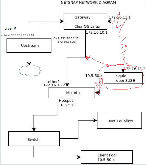

Is it really impossible to have a simpler setup: To install the squid-box 172.16.11.2 just in-between the MT-hotspot 10.5.50.1 and gateway. And then use the squid-box as an upstream-proxy for MT-hotspot, which can be explicitly defined there. No need to define proxy in hotspot-clients, though.
Thank you for your prompt response but i would appreciate it if you could just do perhaps a rough diagram of what am expected to do so that i wont make any more mistakes as i am prone to making mistakes.
I will really appreciate it.
Thank you.
Like this (explicit upstream proxy for MT). Or to let squid run on your gateway, transparent.

In the MT you have to use the Proxy (transparent), and for this MT then to define the squid(SuSE, routing) as parent/upstream proxy. And the squid(Suse) as default gateway. SusE is fine, I have also 11.4 running. No problem. You can generate squid from source, or use a package, which is easier, as it also generates /etc/int.d/squid.
(Your original diagram is also possible to be implemented, but more complicated. Only advantage of it: Only http-traffic passes squid-box, whereas in my simple setup all traffic passes the squid-box. But should not be noticable, unless you have huge traffic. First, keep it simple. Optimizations you can do later on.)
