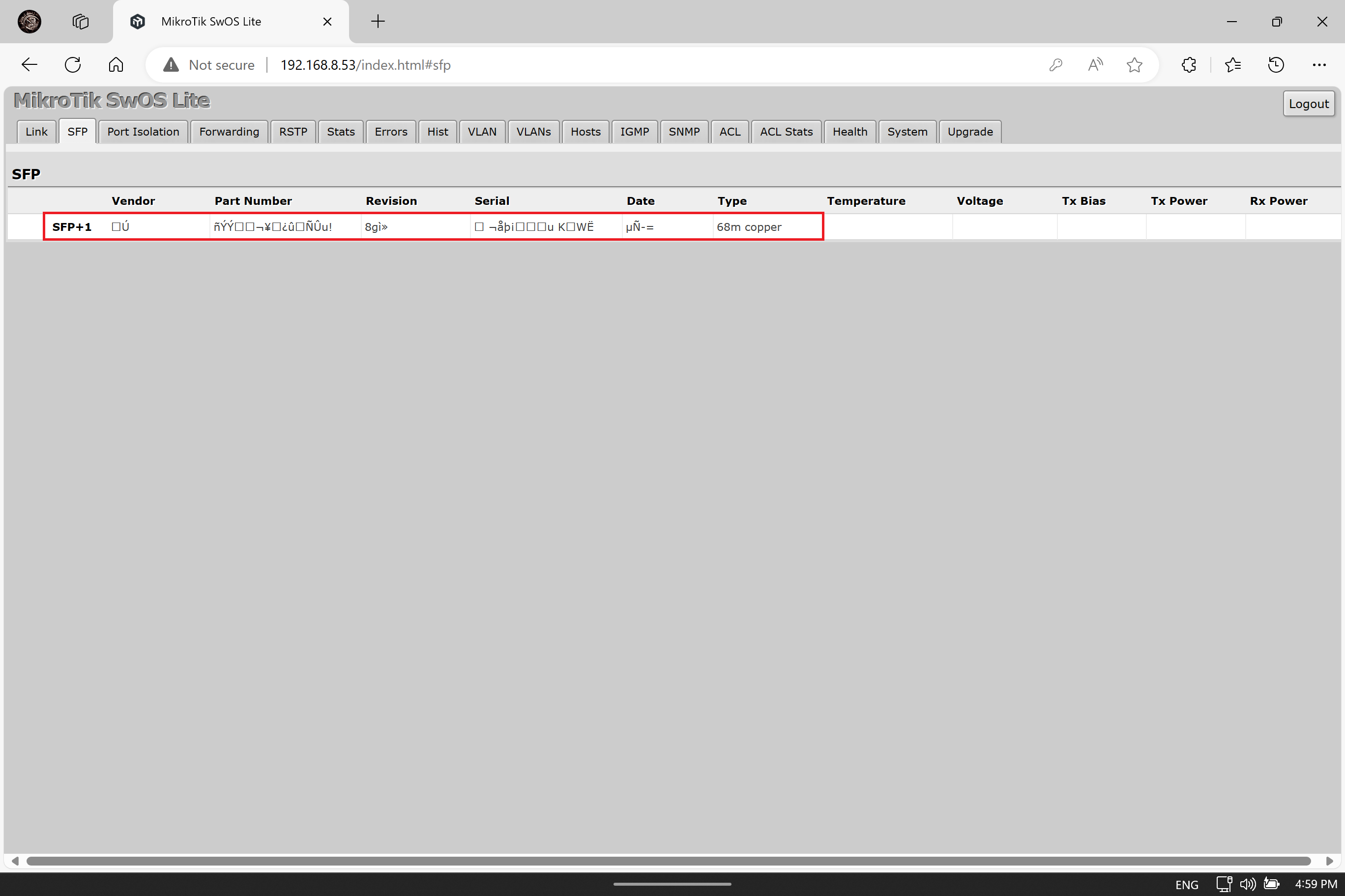

when i use Mikrotik FTC11XG media converter with XGS-ONU-25-20NI this is how Mikrotik FTC11XG media converter converter read it
