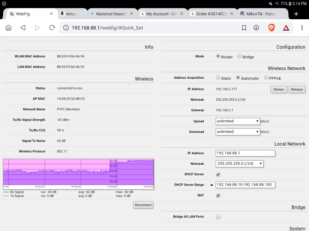

So without touching any settings I rescanned, connected to the new name. It connects just like it always did, says “connected to ess” and gives me an ip address, but there is no internet. (see pic)
I am able to connect directly to the marina’s AP and have internet that way, so I know they are up and running.

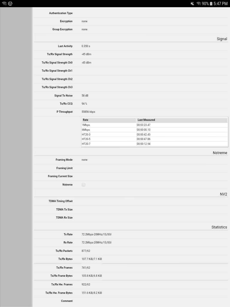

Here is what I see under “registration”.
There seems nothing wrong with that connection.
-“-45 dBm” is VERY strong. I hope that AP is not far away. If it is far away they use a super high TX power, and you might not be able to answer to the AP.
  • signal is pure and clean: 58dB SNR, 94% CCQ
  • 72Mbps-20Mhz/1S/SGI: max encoding density MCS7, single stream, short guard : excellent
  • TX/RX packets 877/62 : wow. That’s bizarre. Very few packets come from the AP. Something wrong in the upper network layers? Or just not reaching the AP with the 877 packets ???
  • 922 hw frames versus 742 frames, not many retransmits, so we reach the AP.
The wifi connection seems clean and good.
Suspecting other layers of the network: IP address, routes, filters and firewall rules, only suspected because there is no obvious problem at the wifi connection.
