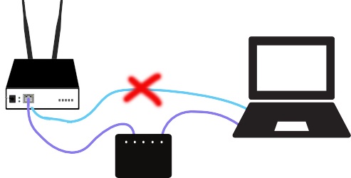

Solution has been found. Simple solution.
One router unbricked.
managed to upload firmware using typical procedure netinstall.
I used a switch (or hub) to connect between Groove and a PC.
If you connect router directly to the PC, the PC interface does not have time to see router, which is already going to reboot.
I think this will be relevant for win users. Haven’t tested this on a linux.
