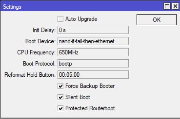

Hello, recently, my RB952Ui-5ac2nD-TC got hacked, and I noticed the admin user has downgraded to read-only mode. I can’t do anything because the bootloader protection is enabled. I assume netinstall won’t work because the method uses reset power, I tried it, but my Mikrotik didn’t show up. Any suggestions? I kind of frustrated; any help means to me, thank you!
On image you have a hint for protected routerboot time!!!
What fortune…
Try netisntal after waiting for protected routerboot after blinking 1-sec-on 1-sec-off for exactly 5 minutes…
Probably MikroTik fix this on following releases, hiding the protected routerboot to non-policy users…
I was not aware of this “feature”. After @rextended’s note, I went looking and found this Protected bootloader documentation.

You had an old version, this is why the hacker could enable it. In new versions, you must press a button on the device to enable it. This is one more reason to always keep your device upgraded.
Now, did you try to restore access with the hold-time ?

The only way such feature can be turned against you, is if you leave your device open to the world and it gets hacked. With firewall in place, there is no way to get hacked like this, unless the attacker is in your LAN and guessed your credentials.
And, like I already mentioned, the feature requires button press, to be activated.
ROS v6.49.1
*) routerboot - enabling “protected-routerboot” feature requires a press of a button;
Thanks for the confirmation @normis.
I found some previous threads, and posted my update here post #27 in @anav’s New Protected Router Boot Mode thread.
The documentation for the reformat-hold-button-max has an inaccurate example that should be fixed, it shows setting to 60s and 65s, but you can’t have a delta time less than 10s (which is a good thing in my opinion). So it should be changed to something like 60s and 70s which I verified is accepted on an RB760iGS with 7.4. (I have reset to 20s and 10m and disabled, this is in my home and I own it).
I also verified that it asks for you to press the button (but doesn’t say which one, I assume reset) if you use /system/routerboard/settings/print and that it reverts to disabled if you don’t press the button (both with the 6.47.10 and 7.4 bootloader firmware on the RB760iGS.
