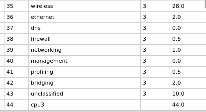

EDIT: This is screenshot of CPU with 5GHz radio detached from CAPsMAN with test speed 300-400Mbps.
No “Networking” and “Firewall” process consume CPU now.
