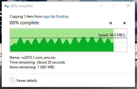

I’ve been testing copying data, to try and get a feel for the speeds. I’m a bit of a novice at this, so my testing methods may be rudimentary. Anyway, whilst copying a file from my local server I get a sort of ‘rollercoaster’ effect. Where the throughput continually peaks and dips, ranging from 51 MB/s at the peak down to 20 MB/s at the dips. It just continually does this up and down the entire time. Looking at the Mikrotik Resources screen, the CPU load only ever tops out at around 40%. I’m wondering what precisely I’m doing wrong and how to get more reasonable speeds, I imagine it must be some sort of configuration since I know the router has 3x3 chains and in theory at least should be capable of much higher speeds.
I’ve attached a screengrab of what I see from the Windows transfer, where you can see the rollercoaster effect (in wired mode this same file copies at 113 MB/s). Additionally I’ve included the Wireless configuration - although disclaimer: I’m not 100% sure how to output the info people may find useful, so I’ve done a print of the wireless menu from WinBox:
Check wireless card driver in your computer. Is up to date?
What wireless card model you are using?
what routeros version ?

Please upgrade to latest 6.38 and reset to default router.
And try again.
Do you have option to test through some traffic generation software like iperf3 ?

Yes just factory rest, default settings should give bet speed.
You can try different 5ghz frequency, taht all.
Looks like that MB is using BCM4360 wireless chip.
You can try this tool http://www.mikrotik.com/download/btest.exe it is not ideal but it works.
on your PC with wireless on then through router to PC with 1gbit ethernet.
