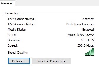

Unfortunately, I’m only getting 300 mbps connection, instead of 867 mbps - see attachment. Over LAN i get 1 Gbps.

The spec for the HAP AC2 quotes 300meg as the maximum speed on 2.4Ghz. I bet that’s what it is. Google finds a few posts about issues with 5GHz on Lenovo laptops, hopefully it finds the solutions as well. Quick check you could disable 2.4GHz on the router.

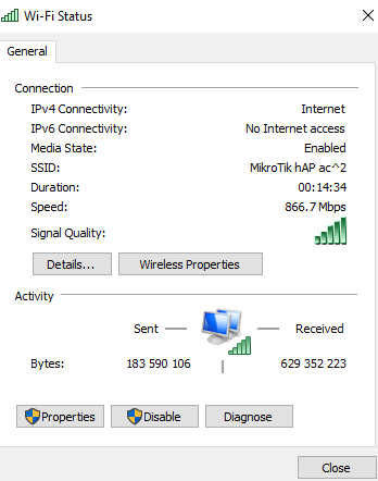

I performed configuration reset, and it seems to work now. What I find strange, is that I’m getting 867 only when I place my laptop right next to the router. Otherwise the speed varies significantly.

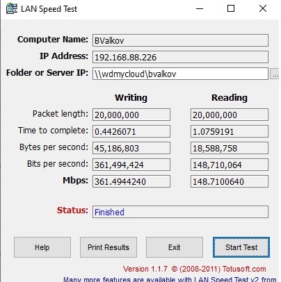

Below I’m sending my current setup and NAS Drive read/write speeds (laptop placed right next to the router).

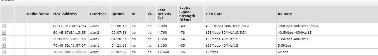

  • See attached Wireless Registration Table - mbps are not static and vary all the time…

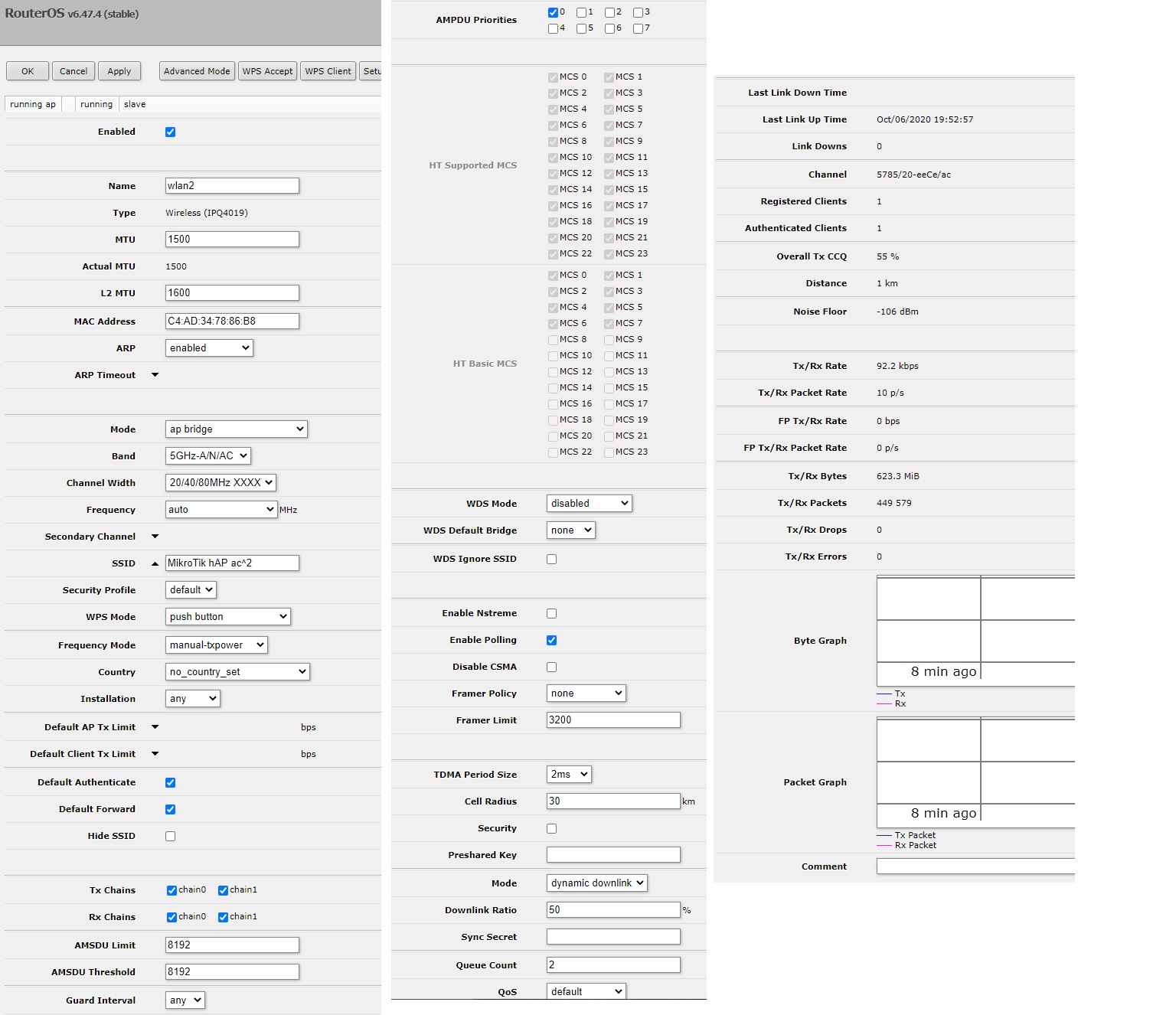

  • Frequency is 5180
    **- I set channel width to 20/40/80/Ceee - Is this a good idea?
  • I put a check on all eight AMPDU Priorities (from 0 to 7) - Is this a good idea?**

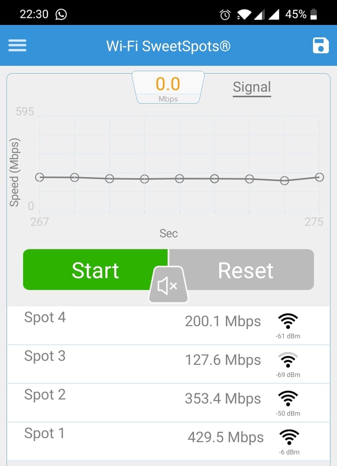

I also measured the effective speed via an android app - fastest speed is right next to the router, while the others are random spots in the house.

It is jormal for you to get 867mbps datarate. Your laptop wireless card seem to support 2 streams with max 160mhz channel width. While the hap ac2 supports 2 streams too, but it only supports 80mhz channel width. So 867mbps is the expected outcome.
OK. Your wifi spectrum in the room is disturbed somewhat.
RX rate is almost at the MAX speed (MCS08. See http://mcsindex.com/)
In the TX rate the AP was not able to communicate with the 2 streams , only 1S. Is a sign of a distorted or disturbed signal (might have a too strong TX power set in the AP)
(-40 dBm is a very strong signal, -30 dBm can saturate a receiver)
Now you know where to look! And add the TX/RX CCQ column for the signal quality, should be 95% and above.
Rates only come after enough traffic has passed. Before that the numbers are very unpredictable.
I hope the 5th device improves with traffic. The signal strength is excellent, but the CCQ might be very low if it remains low. A slow device uses more “air time” and blocks others!
I don’t know the Wifi Sweetspots APP, but if that Spot 1 is a real measurement, then this is a problem. -6 dBm is enormous, even dangerous to human health. 100000 times stronger than normal. Even at a different frequency it is likely to interfere. Please use “Freq Usage” and “Snooper” to check for the spectrum around. It is probably not a real signal measurement.
Out of the box, there are no mangle rules to change the priority, so A-MPDU for priority 0 is used all the time. Setting the others is OK. But should not be done for voice (6 -7) as this is not high volume but delay and jitter sensitive. WMM is needed to activate the priority queues. And own mangle rules are needed to set the priority, or all is priority zero !
