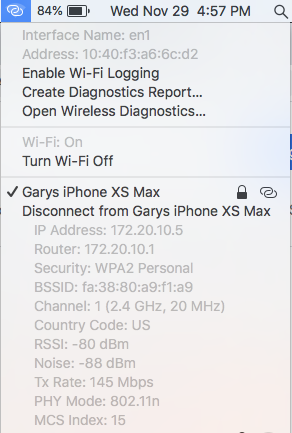

Use wifi analyzer (https://play.google.com/store/apps/details?id=com.vrem.wifianalyzer) on an Android phone or find a similar software for iphone.

AC3 connects to wifi of hotspot via one radio (2.4GHz or 5GHz, up to you to choose. See further).
Other radio is used to provide new wifi-SSID for other clients (with own subnet, NAT, firewall, …)
For devices with 2 radios, this is the best approach since it provides the least interference on the upstream wifi connection.
Keep in mind 2.4GHz via wifiwave2 drivers will perform quite a bit better then legacy wifi.
That’s the connection which will possibly be your bottleneck from end-to-end point of view though I suspect it will be in reality your mobile connection on iPhone, hard to believe it will be consistently faster then 350-400 Mbps.

Everything I have read states that iPhone XS Max only uses the 5Ghz radio for Hotspot and the 2.4Ghz radio Hotspot can only be enabled on iPhone 12 and above. However, it seems everything one reads isn’t true.
On my Macbook Pro, I discovered that when connecting to my iPhone XS Max Hotspot it is actually using the 2.4Ghz radio:
What’s strange is scan under the Mikrotik hAP ac3 wlan1 interface doesn’t provide any results. However, I was able to successfully configure the wlan1 repeater (in the blind) with my iPhone XS Max Hotspot.
