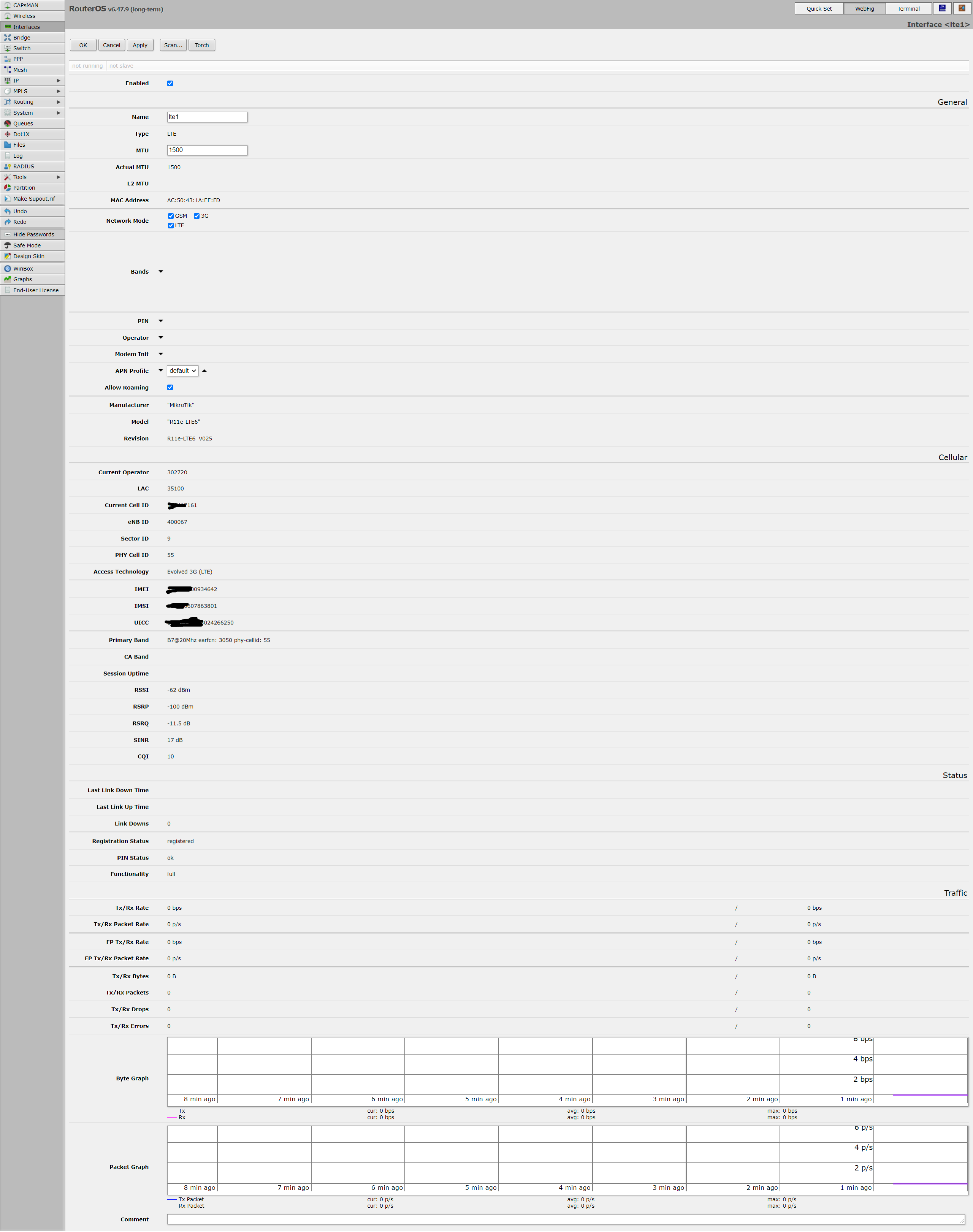

Hey guys. I was wondering if anybody knows if this device works on the Canadian Rogers network?. I was trying to set it up but cannot get any traffic. I was wondering if my config is incorrect or the network is not supported.

MikroTik-Interface-lte1-at-admin-192-168-88-1-Webfig-v6-47-9-long-term-on-RBD53GR-5HacD2HnD-arm-.png
What is your APN-Config ?

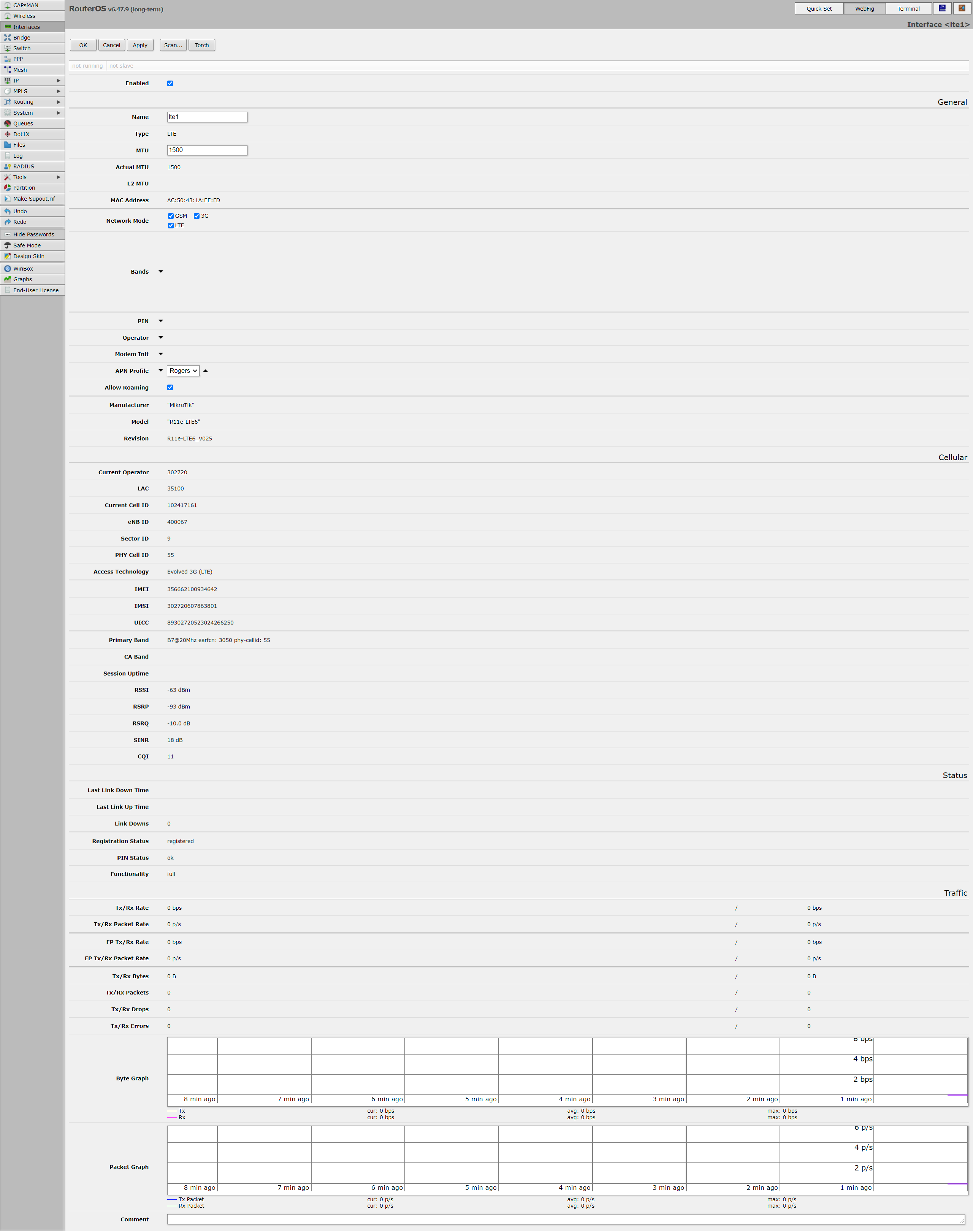

Thank you, i did but still the same. Here is what I have now

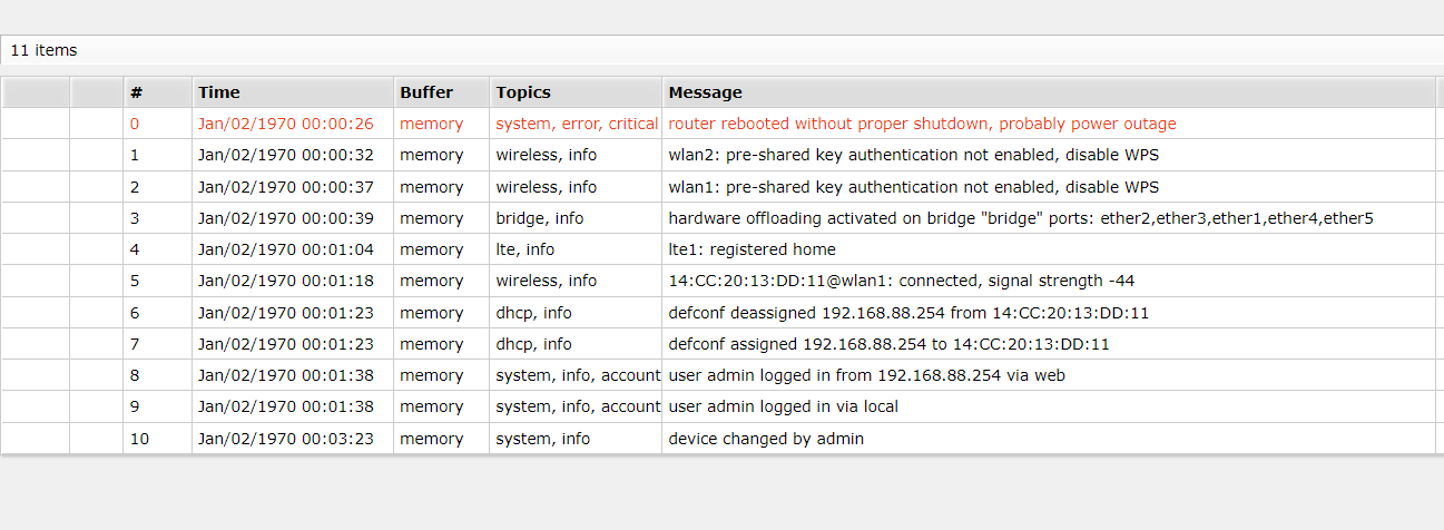

What do the Log says ?

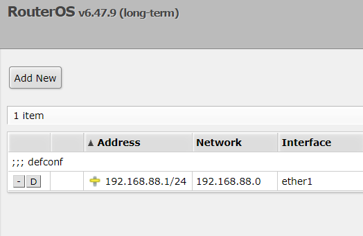

Can you please make a Screenshot of
Menu → IP → Addresses
AND
Menu → LOG
Thank you for the Screenshot’s
I still don’t understand why the interface isn’t up and running!

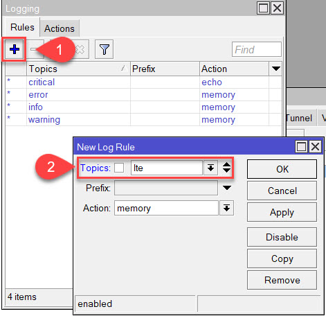

So you will have to activate LTE-Logging
Go to Menu → System -->> Logging -->> Add Rule (+) -->> Topic LTE -->> Save (press OK)
After that, restart your Router and post the the Screenshot of the LOG again !

Thanks for all the help. Here is the log:
https://tinyurl.com/ydncfvvd
Try this APN:
/interface lte apn
add apn=ltedata.apn name=Rogers2
Added
And working ?
Yes, finally. thank you!

P.S: you may want to disable the “LTE” logging, you enable yesterday.
