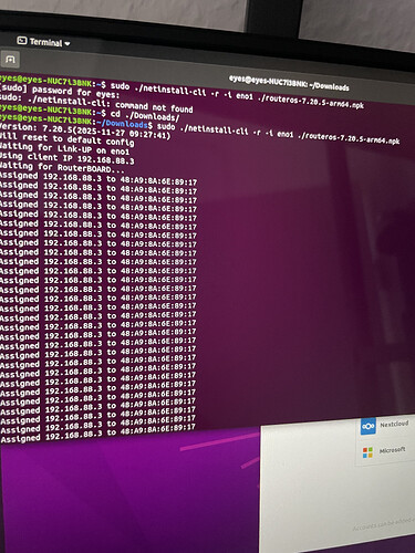

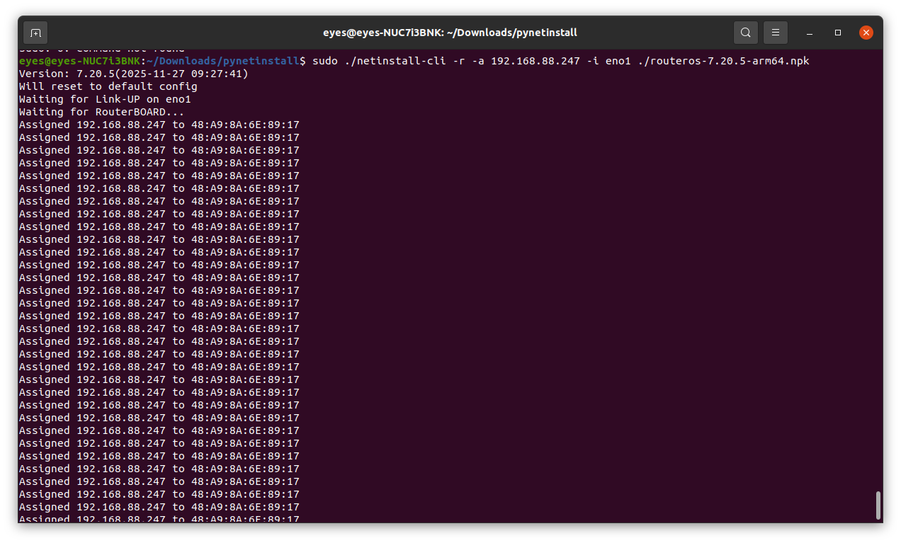

    I noticed that when I run netinstall-cli on Linux I never see the line “PXE server started” (or any mention of the TFTP server starting), only endless “Assigned 192.168.88.3 to 48:A9:8A:6E:89:17”.

Let me try to describe my steps. I might be making a mistake at some point. First, I download and unzip NetInstallCLI and the same version of Routeros. Then, on the network interface, I assign the address 192.168.88.2 and mask 24. Then I run the command line as in the screenshots. The patch cord connects the Ethernet port of the nuke to port 1 of the Mikrotik. Then I hold down the reset button and apply power to the Mikrotik. I wait until the command line with requests (as in the screenshot) appears in the terminal and release it. I usually hold it down for about 35 seconds. I tried not releasing the reset button, but that didn't help either.

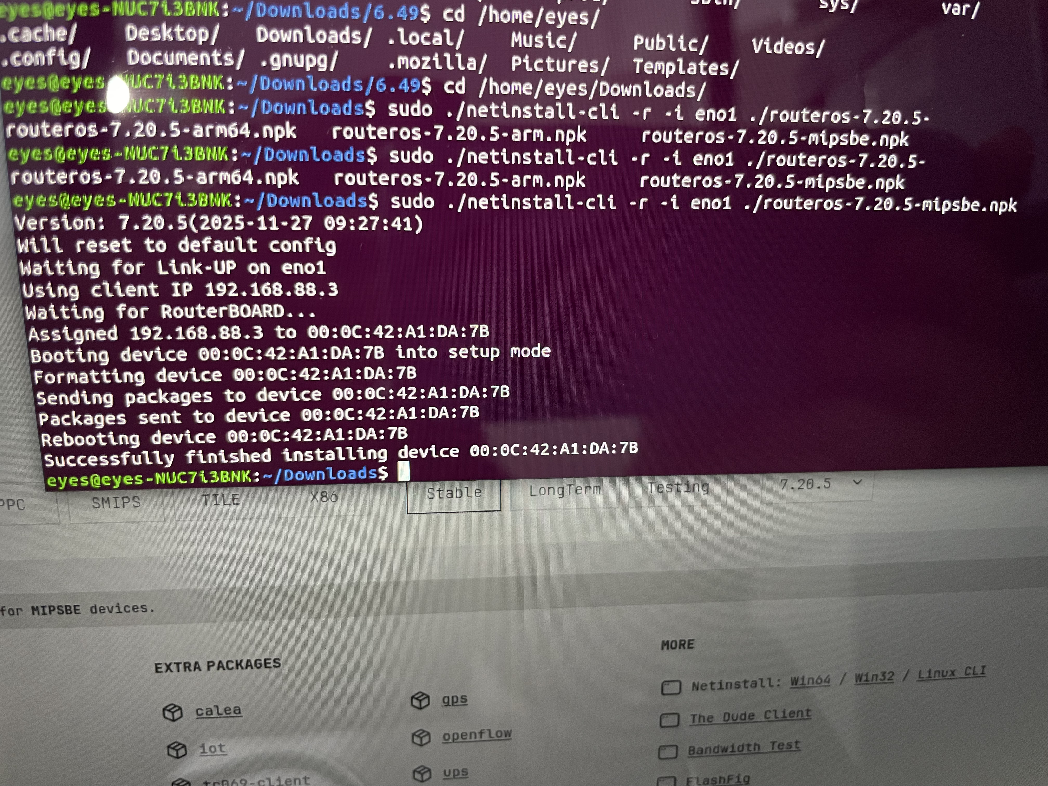

I just decided to check if I was getting errors with another device. RB750. It flashed successfully.

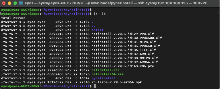

Unfortunately, my knowledge is probably not enough to follow your instructions. I created a folder and copied two directories from git into it(dhtest + pynetinstall). According to the instructions from pynetinstall, I received various files, including:
there were no problems with this part:

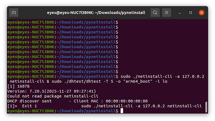

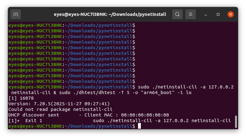

sudo ./netinstall-cli -a 127.0.0.2 netinstall-cli & sudo ./dhtest/dhtest -T 5 -o "arm64_boot" -i lo
but here an error was already waiting for me:
I understand that he doesn't like the executable file, but I can't figure out what else to give him. I know this is a pretty stupid question, but maybe you can correct me. Thank you.

Now you have extracted the RouterBoot Netinstall (the arm64 elf file) image with the python code from the netinstall.exe file.
You don't need to use the dhtest app.
That app was used before to extracting the code before the python method.
So now you have to use dnsmasq command to send the RouterBoot Netinstall image (the arm64 elf file) to the device and then run the netinstall with the same ip like you leased out with dnsmasq command.
So this netinstall-cli is sending stage 1 to the device, and the device is running that to get the stage 2 that is tha RouterOS from the netinstall-cli. The stage 1 is being running in the device that formatting and flashes the RouterOS into the nand.

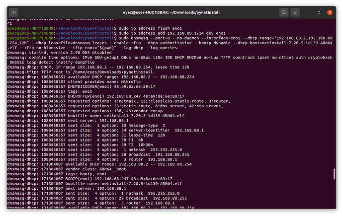

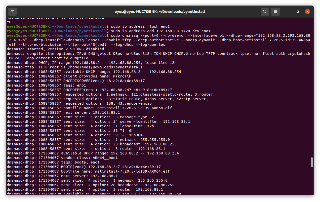

sudo dnsmasq --port=0 --no-daemon --interface=eno1 --dhcp-range="192.168.88.2,192.168.88.254,12h" --dhcp-leasefile=dnsmasq.leases --enable-tftp --dhcp-authoritative --bootp-dynamic --dhcp-boot=netinstall-7.20.5-id139-ARM64.elf --tftp-no-blocksize --tftp-root="$(pwd)" --log-dhcp --log-queries
You shuold see that the file is being send to the device, and after the file being sent you just press CTRL and C to stop dnsmasq command. Then run the regular netinstall-cli, and take a note what ip the device being leased out and then put that ip adress into the netinstall command.
sudo netinstall-cli -r -a 192.168.88.2 -i eno1 ./routeros-7.20.5-arm64.npk

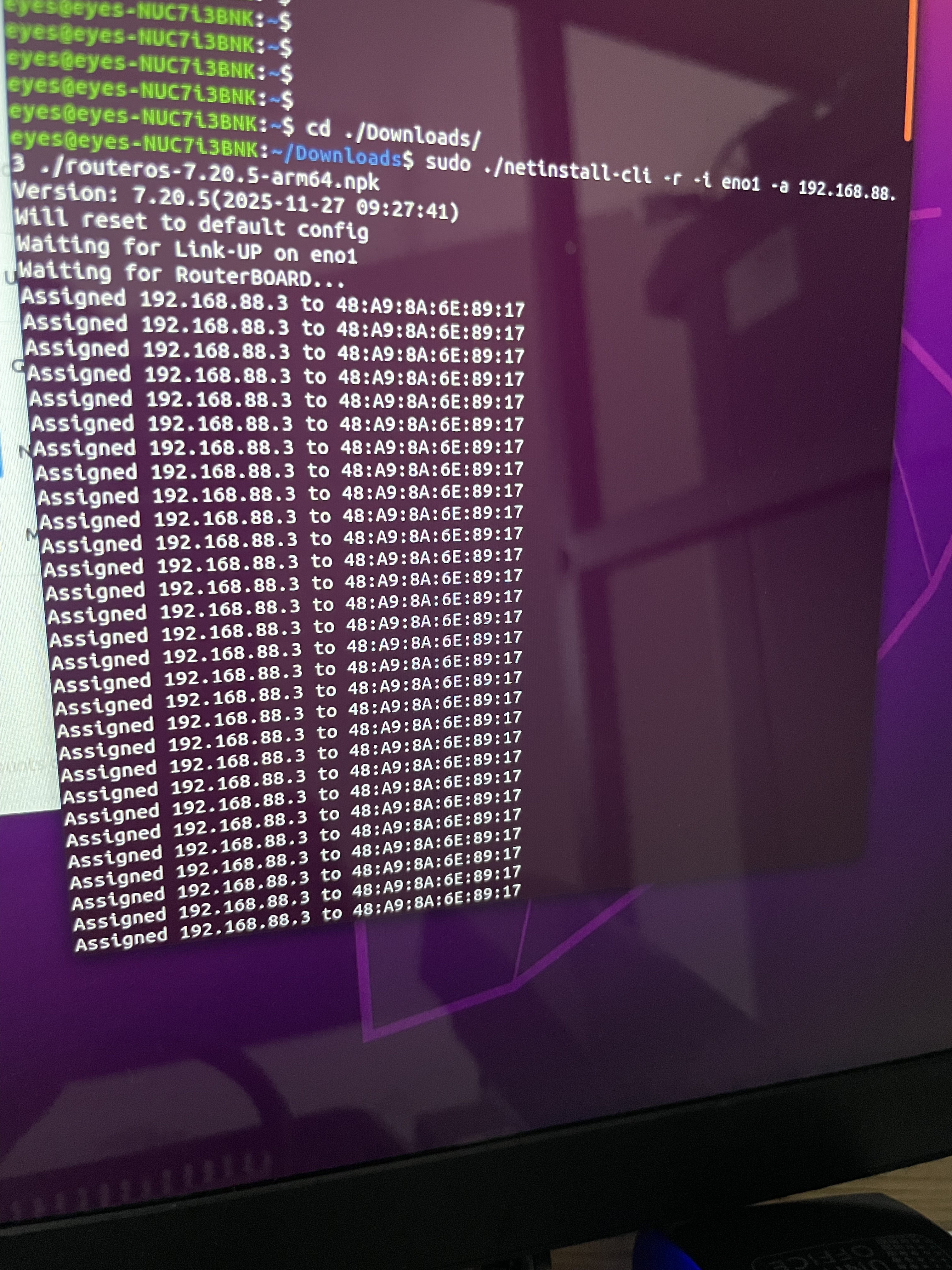

I'm not giving up, but it looks like the problem is deeper. I did everything as you advised, but the result remained the same.
What confuses me is that I don’t see the line about "PXE server..."
I like what I see.
But I don't see that the file is being sent in the log.
Like that log I get:
dnsmasq-tftp: sent /home/patrik/Projekt/mikrotik/netinstall.mips to 192.168.88.4
