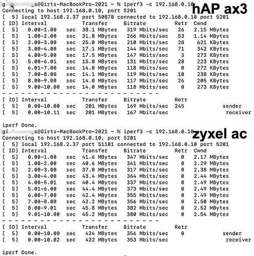

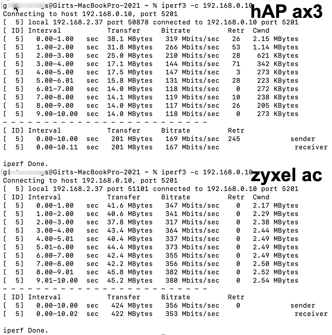

Why on my new Mikrotik hAP ax3 wifi speed is so low and also Retr number high?
I have tested all possible WiFi settings, no changes at all. Faulty device?
On my old Zyxel AC access point I see different numbers.
I'm pretty sure that low average throughput is due to (excessive) retransmissions ... because dropped packets (and hence retransmissions) really kill throughput when using TCP connections (due to shrinking TCP window).
You may want to try testing using UDP connections. It's not affected by dropped packets (it will report that though), so it should point at the culprit: is it slow wifi interface or is it dropped packets. And mind that dropped packets might happen elsewhere, not necessarily on wifi interface (some MT devices are known to poorly handle speed changes, e.g. between wired ports running at different speeds).
