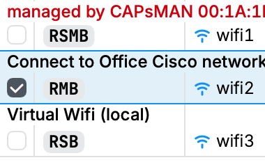

I am connecting my AX3 to office network using Cisco AP via 2.4GHz wireless. Just using usual travel router configuration
I use station mode to connect. Following the ways to share the wifi to the other devices connected to AX3
wifi2 is the 2.4 G radio
wifi 1 is 5 G radio managed by remote Capsman
wifi 2 is slave of wifi2 for mobile devices to connect
