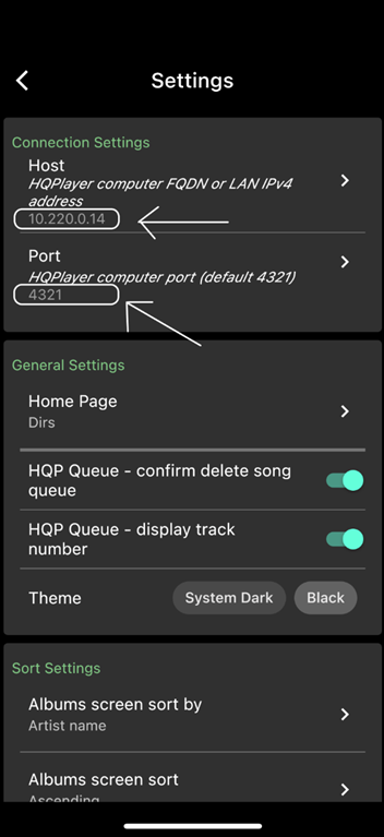

Setting up a connection between the client app on the phone and the server application on the Mac Mini is basically really straightforward, for which see the screen shot below.
When the client app is provided with the IP address of the Mac Mini as assigned by the Vilfo VPN router (10.220.0.14) and the port the server application listens to (4321), a connection is set up, and the app can give commands (e.g. select album, start playing, adjust volume etc.) to the music server application. However, this is as long as my iPhone is connected to WiFi network as broadcasted by the Vilfo VPN router (connection Ia). The moment I switch and connect my iPhone to the WiFi network that comes from the MikroTik hAP ax2 (connection Ib), the connection between the client app and the music server application is lost, and there is no way re-establishing it.

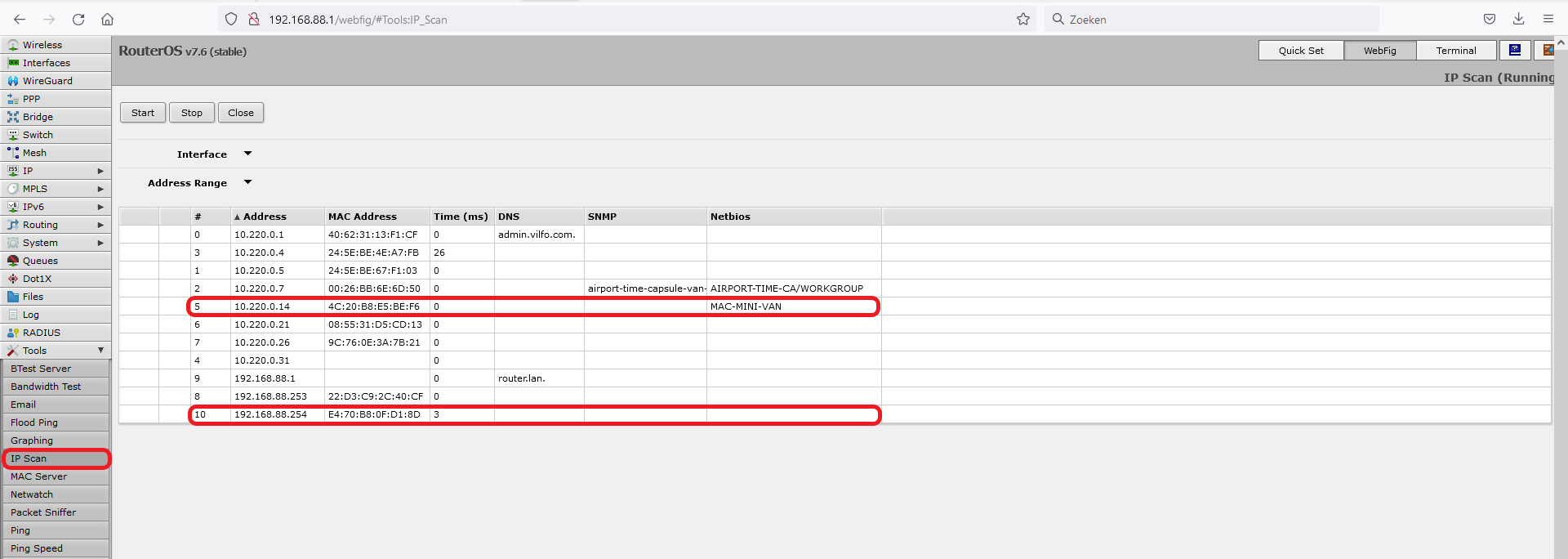

It is not as if the MikroTik hAP ax2 does not ‘see’ my Mac Mini, though. When I connect my work laptop to its WiFi network (connection Ib) and log in at the management console, I can run an IP scan, the results of which show my Mac Mini at address 10.220.0.14, as well as all other IP addresses as assigned by the Vilfo router (192.168.88.254 is the laptop, and the address right above it my iPhone when connected to the same network).

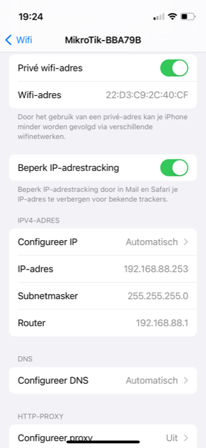

And when it is connected to the WiFi network broadcasted by MikroTik hAP ax2 (connection Ib), the info panel is as follows:
