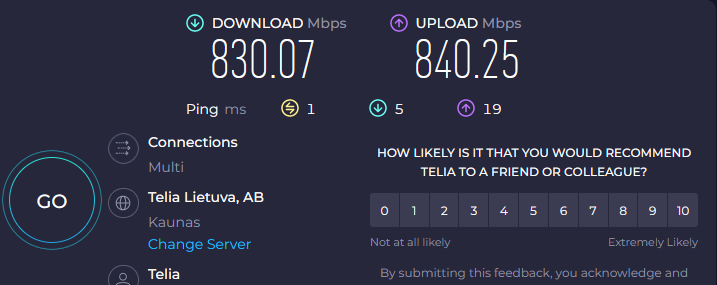

there two pic one of them with mikrotik router

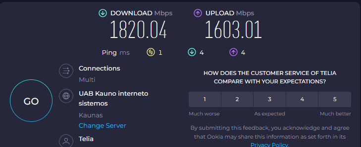

and another one is lan cable connected directly to pc lan port with 2.5 gb
Again: how exactly does the network topology look like when hAP ax3 is in the picture?
BTW, when doing speedtests, try to select same server every time. My experience is that some servers some times give lower results than others. If your ISP runs their own speedtest server, use that one, many ISPs go to great extents to make sure their servers give top-notch results to their customers.
If isp modem is connected to port 1, which is the ONLY 2.5gb port ax3 has, and pc is connected to any of port 2 to 5, which are MAX 1gb ports, how do you expect to get more then 1gb on PC ??
Impossible.
