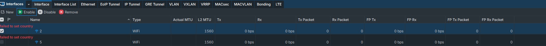

Hello, yesterday i upgraded to version 7.21.3 and today it stopped working, and I realized that the interface displayed “failed to set country” even though it had been selected. Has anyone encountered this error? I have Mikrotik hap AX3.

Ive just noticed that the 5Ghz died too which isnt usually caused by USB.

seems to be a common error: 7.21.2 "failed to set country" on hAP ax3 (both wifi1 and wifi2)
It was fixed in 7.21.3 :person_shrugging:t4:
I encountered this problem for the first time today. Restarting the router hap ax3 helped. RouterOS version is 7.21.3.
