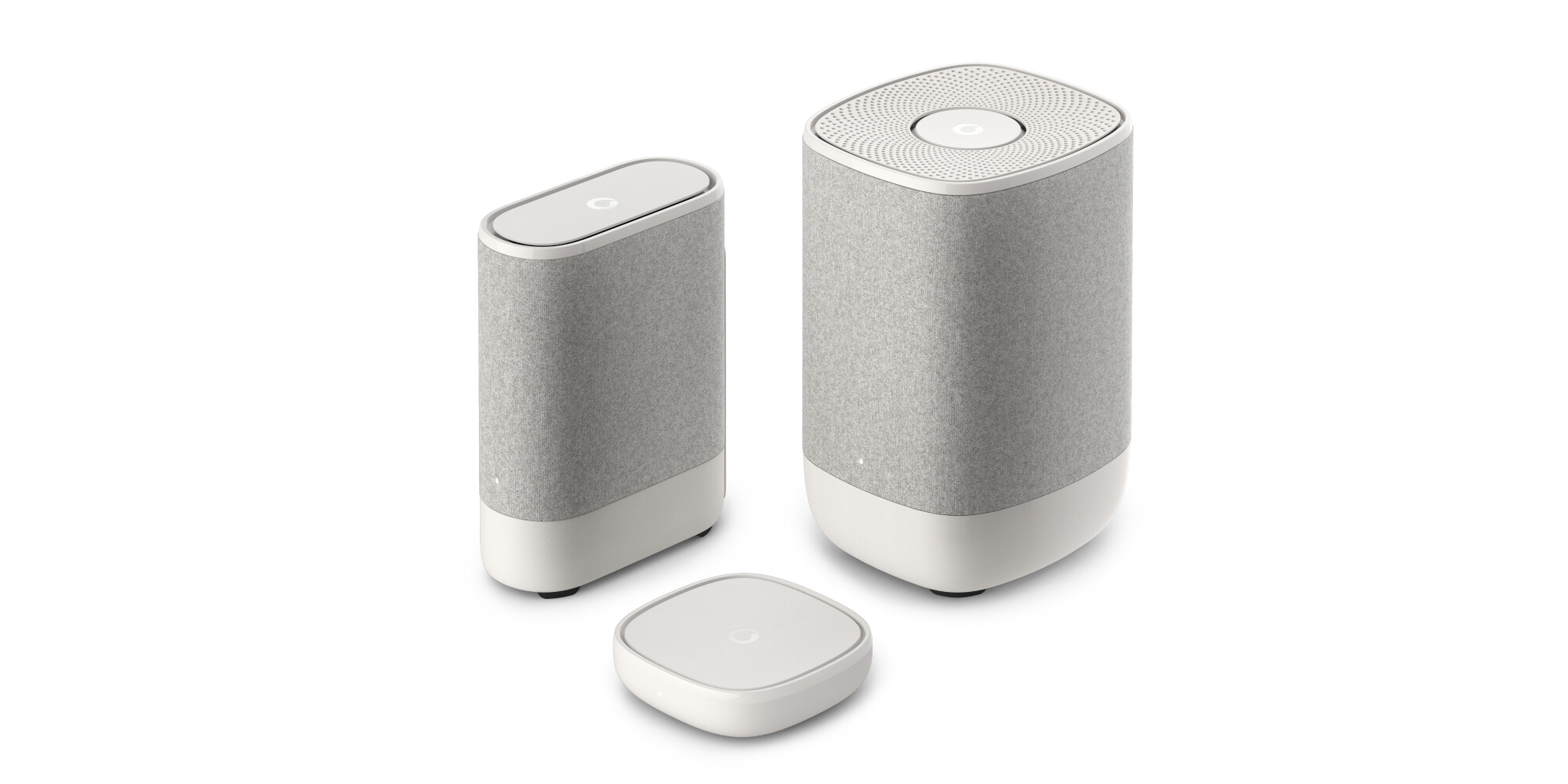

what unit 6E do you have?

Hello. I have the Vodafone Pro II Ultrahub 6E - Vantiva produced unit for Vodafone (used to be called Technicolor)
Can’t get anything anywhere near this to match the speeds and range. (Happy for suggestions, anyone :smiley: …)
https://www.vodafone.co.uk/broadband/pro-ii-devices
https://www.benzinga.com/pressreleases/22/10/n29318193/vantiva-and-vodafone-deploy-uk-markets-first-wi-fi-6e-gateway
I’ve tried
1/ Mikrotik hAP ax3 - poor, as described above (even with 7.6 FW re-installed )
2/ ASUS RT-AX86U Pro, which is supposed to be excellent, but I’ve found is about 70% as good as the Vodafone unit (same location), same conditions.

The bizarre thing is the the Vodafone Pro II Ultrahub reaches everywhere in my house, even 2 levels up I’m getting 600 down/300up and this is 12 meters away through blockwork walls. Best WiFi i’ve ever had for a single unit!
I’m also contemplating using the Mikrotik hAP ax3 with the Vodafone Ultrahub router as a dumb access point (not sure how this will work though - i’ll just give it a fixed IP, turn off DHCP and let the MT do it’s stuff). I just wish we were able to get custom firmware for the Ultrahub and flash it and remove the crippling Vodafone software. Can’t find anything about how to do this though as the device is locked down. Also there are separate boosters for the Vodafone unit, but the ethernet backhaul isn’t supported by Vodafone (again locked down by their custom firmware) so no control of these.
MikroTik does not have any WiFi device that can compete with the Vodafone Pro II Ultrahub 6E.
