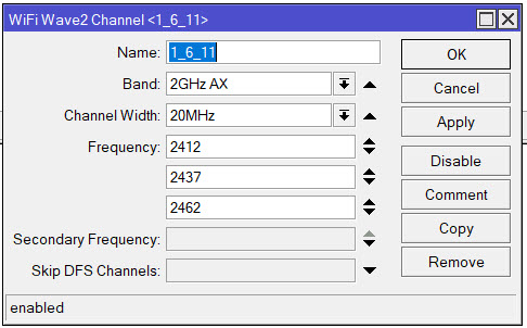

AUTO does a one-time scan at each boot to find the “least used channel” and selects that. It then configures the highest allowed TX power according to local regulations for that channel.
As usual this is far from optimal. You need to make at least a channel list with channels 1, 6 and 11 (2412, 2437, 2462 MHz) for 2 GHz and apply that, or else it will choose a random channel like 3 or 8 and foul up the carrier detection in the area. Really substandard that MikroTik does not use 1-6-11 channel selection by default.
Also (like many other manufacturers) it does not do a re-scan of the spectrum at any time after boot. So changed circumstances on the RF spectrum are never taken into account.

But at work I have installed a system from the other well-known competitor in the “cheap” market segment, and without any configuration it selects only channel 1, 6 or 11 when setting to auto. So it can be done.
On my MikroTiks at home I use this channel list:
/interface wireless channels
add band=2ghz-b/g/n frequency=2412 list=ch1_6_11 name=ch1 width=20
add band=2ghz-b/g/n frequency=2437 list=ch1_6_11 name=ch6 width=20
add band=2ghz-b/g/n frequency=2462 list=ch1_6_11 name=ch11 width=20
Good channel list.
I don’t trust “auto”, not even the XXXX in 20/40/80 XXXX. Check the 80 MHz channel alignment !
http://forum.mikrotik.com/t/v6-49-4-stable-is-released/156240/1
Too bad wifiwave2 doesn’t allow constructing frequency lists
 or does it? Entries under /interface/wifiwave2/channel don’t seem to have property list available?
But you can :smiley:
Tab Channel, frequency, use the drop down arrow to add frequencies.
