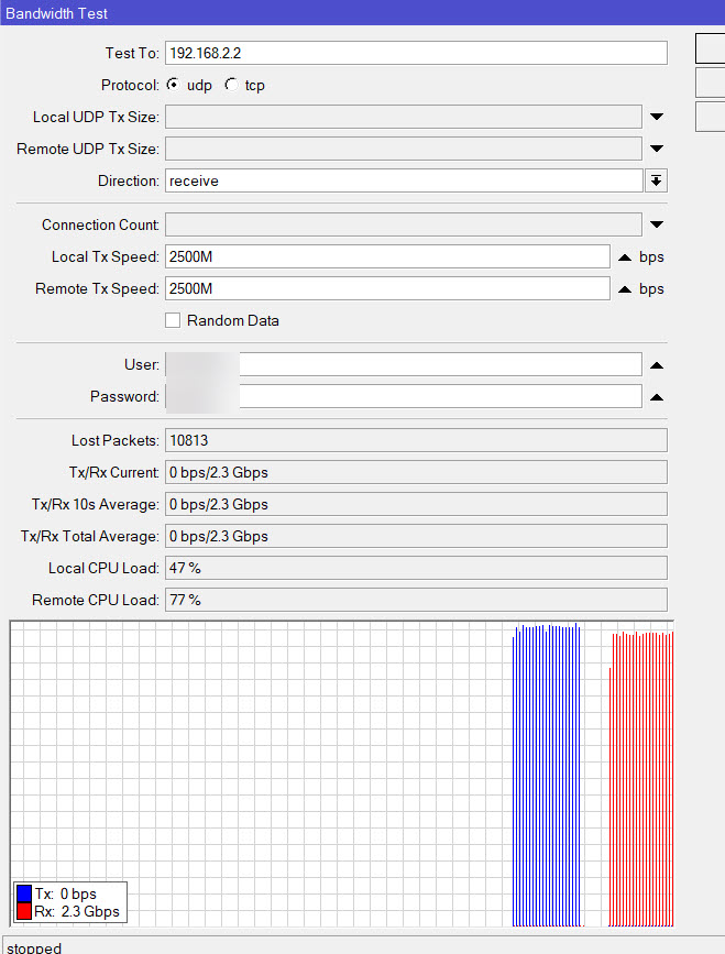

Btest results from AX3 to rB5009, first send, then receive (other way around performing test on RB5009 towards AX3 is same)
On send cpu on AX3 was close to 100%, on RB around 75-80%.
On receive (oddly enough) it became around AX3 70% / RB 50%. Not clear to me why there is such a difference but as we all know, btest is not to be run on the device itself you are testing. Those are the only ones I have with a port capable of 2.5Gb so nothing else available to fill that pipe :laughing:
Someone will surely make a remark about the packet loss. I redid the test using TCP, results as follows:
AX3 → RB5009:
RX: 2.1Gbps
TX: 940Mbps (CPU local on 34%, remote on 53%)
0 packet loss

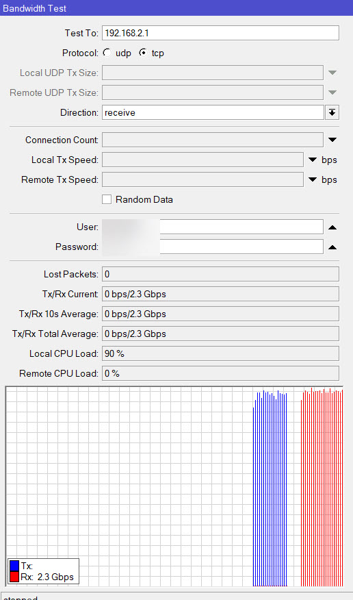

And now some will be triggered, so redid the same test from RB to AX3:
TX 2.2 Gbps
RX 2.3Gbps (CPU on AX3 was not 0%, that’s a bug I’ve seen appearing from time to time in that tool. I saw it was around 91%)
0 packet loss
The connection between AX3 and RB5009 is as far as I can conclude perfectly capable of delivering those speeds in both directions.
