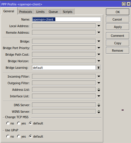

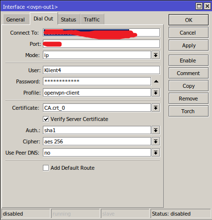

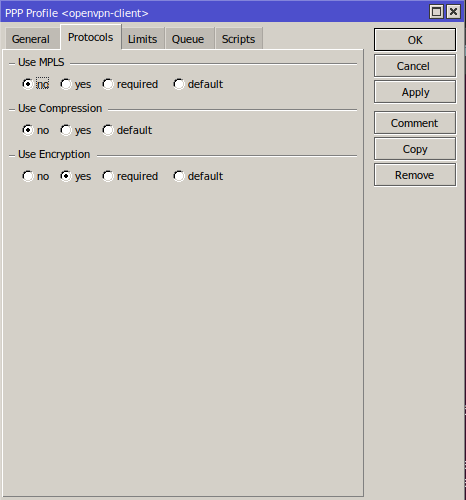

I configure interface:
profile:

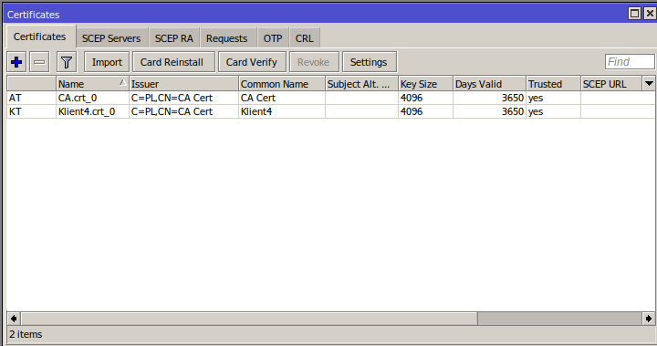

certificats:
And I getting filed:

Likely you have selected the wrong certificate for the OVPN client - it should be the client certificate, not the CA or server certificate.
The CA and any intermediate certs used by the server only have to be installed under System > Certificates so the can be found when Verify Server Certificate is enabled.
I change it to client certificate, and now it is working! Thank you!
