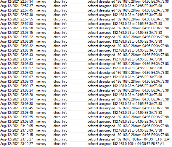

I have a Mikrotik HAPAC2 firmware 6.48.1 as my main router, as soon as I connect a Tenda F9 Router to it in default router mode everything works fine. Except I want the mikrotik to give out IP’s so I change the Tenda to AP mode. But now something weird is happening, the interface restarts every couple of seconds, and this happens at 2 different places and only as soon as the main router is a Mikrotik. When I keep the LAN connection between my pc and the accesspoint plugged in and remove the main link from the mikrotik the AP does not restart the interface. Am I doing something wrong?
I attached the log from the mikrotik.

Hi thanks for the reply. The Mikrotik’s internal antenna is to weak for the range so I added the Tenda f9 Router/Access point with 4x6dbi antennas. I tested on another mikrotik and its working there so I presume it must be a configuration error on the HAPAC2.
I added the file as requested.

i have thow into the recycle bin all the tenda, because on ap-mode sometime turn on dhcp server and on settings don’t are any menu to disable it…
