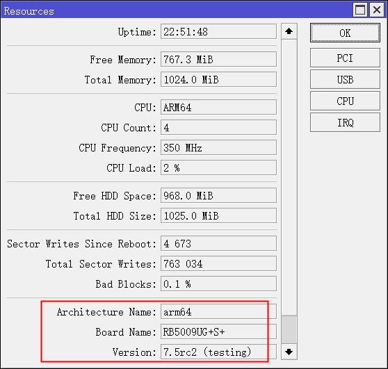

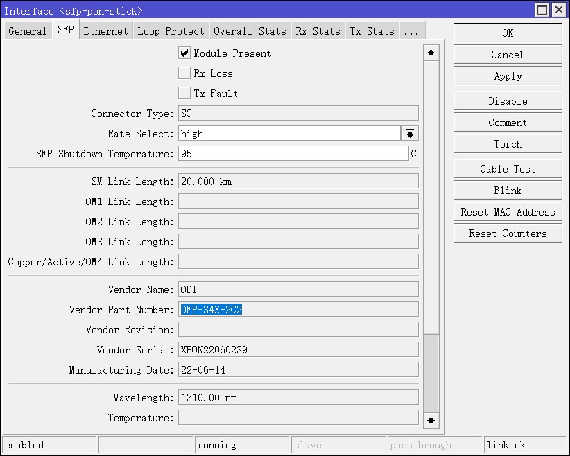

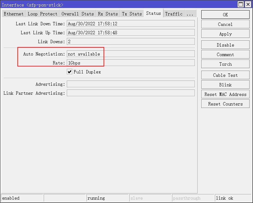

facing same problem based on rb5009 + odi gpon stick DFP-34X-2C2,
didn’t work on version v7.4.1stable & v7.5rc2,only can get 1Gbps,auto negotiation shows: not available
