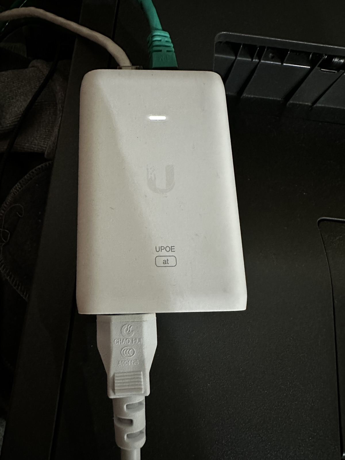

I am using the original power adapter for this U-POE-at
Ubiquiti U-POE-at
